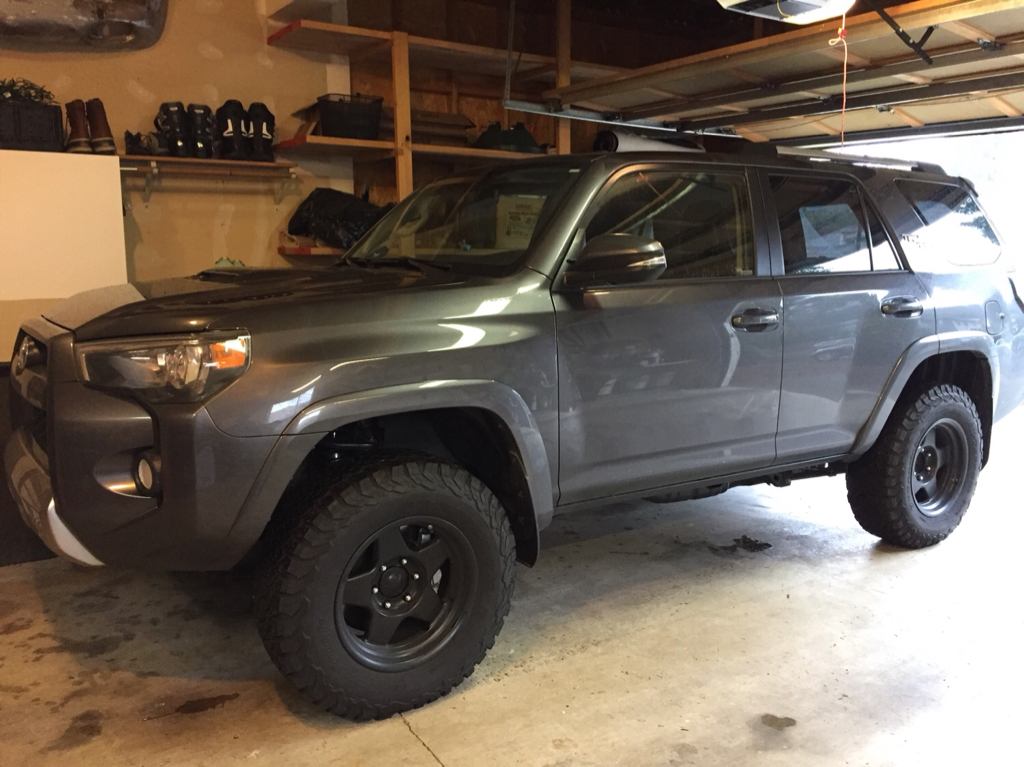

I ordered the 6112/5160 combo and am looking to see if anyone has pictures of the .79 (2/1)or 1.14" (3/2) settings and stock rear. Debating on going with either that or ordering 1" rear dobinson springs and setting front to 1.85" (5/4), however keeping the stock 265/70/17 size Nitto G2's so not sure how bad it would look.

I can dig up some pics. I went 4/3 with factory rear before switching to 7/6 with rear springs. EDIT: here you go. tires were 265 KO2.

Excellent! If you have any side profile shots with that setting, I'd love to see them. This actually works well for me as we have the exact same year, trim and color and I want to get black F5's at some point to replace the TRD Pro wheels I have now, but your previous post about rubbing has me worried.

I will look. With the wheels and those tires there was rubbing that required some trimming of the front inner fenderwell/bumper.
Looks good, I can't quite tell, but would you say it still retains a very small amount of rake?
Yes,
