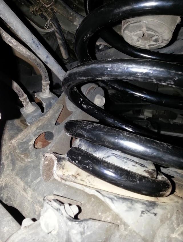

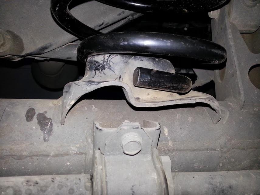

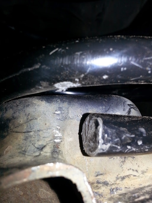

I waned to ask for advise – as Moog FJ coils are a bit smaller, I wanted to ask if the coils seating on the axle looks correct and safe
Driver side:
Passenger side:
Thank you!
Driver side:
Passenger side:
Thank you!
My rear moog coils are sitting just like that. I have yet to notice any adverse affects from it. No noise or uneven looking. Took it off roading a couple of times just to see if it would unseat or make noise. Nothing so far. But with that said I did manage to get my hands on some FJ coils so those will be put on in the future. No rush to do it since the moogs are doing fine. :lookout:
Thank you chompster4runner
Will soon try on on offroad!
Seconded: Thats exactly how mine sat for the first few days. They still haven't seated perfectly, but they're in there snug.

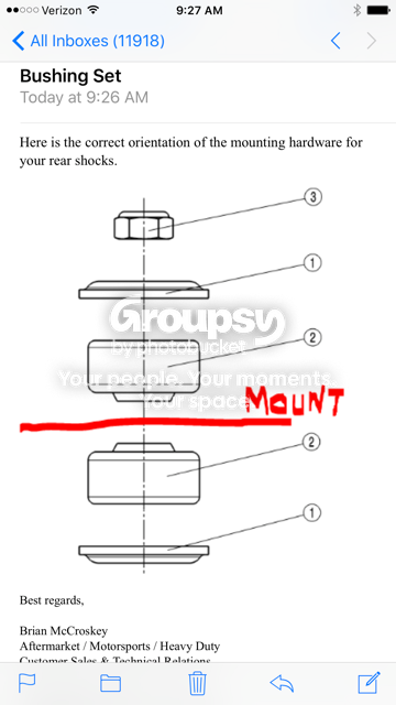

One thing I'd add/correct is the rear shock bushing orientation. The way you had it didn't seem right so I did some research and found this posted on the FJ forums.
