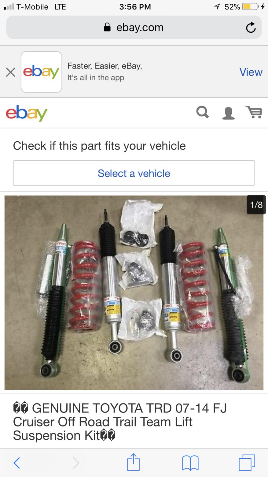

Are these just 4 bilstein shocks or shocks and springs? 487 is killer. I’d order it right now.

I believe the "kit" parts are as follows:
2x 6112 front shocks
2x 600 pound front coils
2x 5160 rear shocks
Not sure about the additional hardware
Does someone know for certain that these will fit a 5th gen w/ KDSS? By "fit" I mean without modification. Thanks.

I'm guessing reservoir mounts? That begs the question, what are the odds the 4Runner has the same mounting locations/holes as the FJC?
i just checked camelback toyota, its 573 there for whole kit. there will be shipping but still...smoking deal for trd pro kit! should fit fjs, tacomas, and 4runners.

This seems too good to be true lol. Camelback toyota is 4 miles away from me. might look into this tomorrow. I'd swap the front springs out for some dobinsons to get 2" of lift instead of the 1" the trd pro's come with.
I’m not quite sure on the amount of lift these 6112’s w/600lb eibachs will give.
But I would bet there are different coils that would work for different amounts of lift....or one could use a top plate spacer for desired lift and extended bump stops.

I'm pretty sure the Pro uses a 520lb spring...
