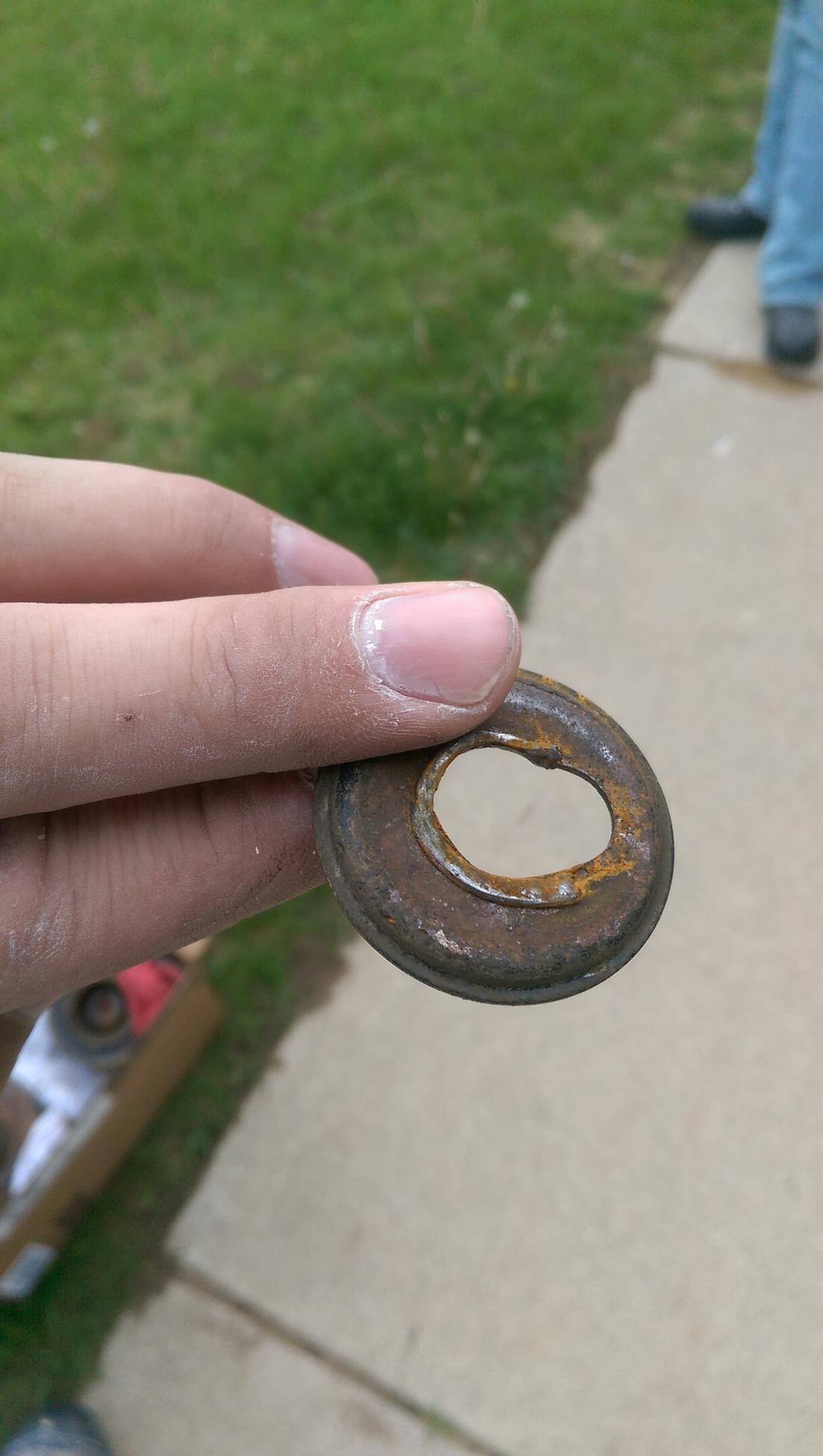

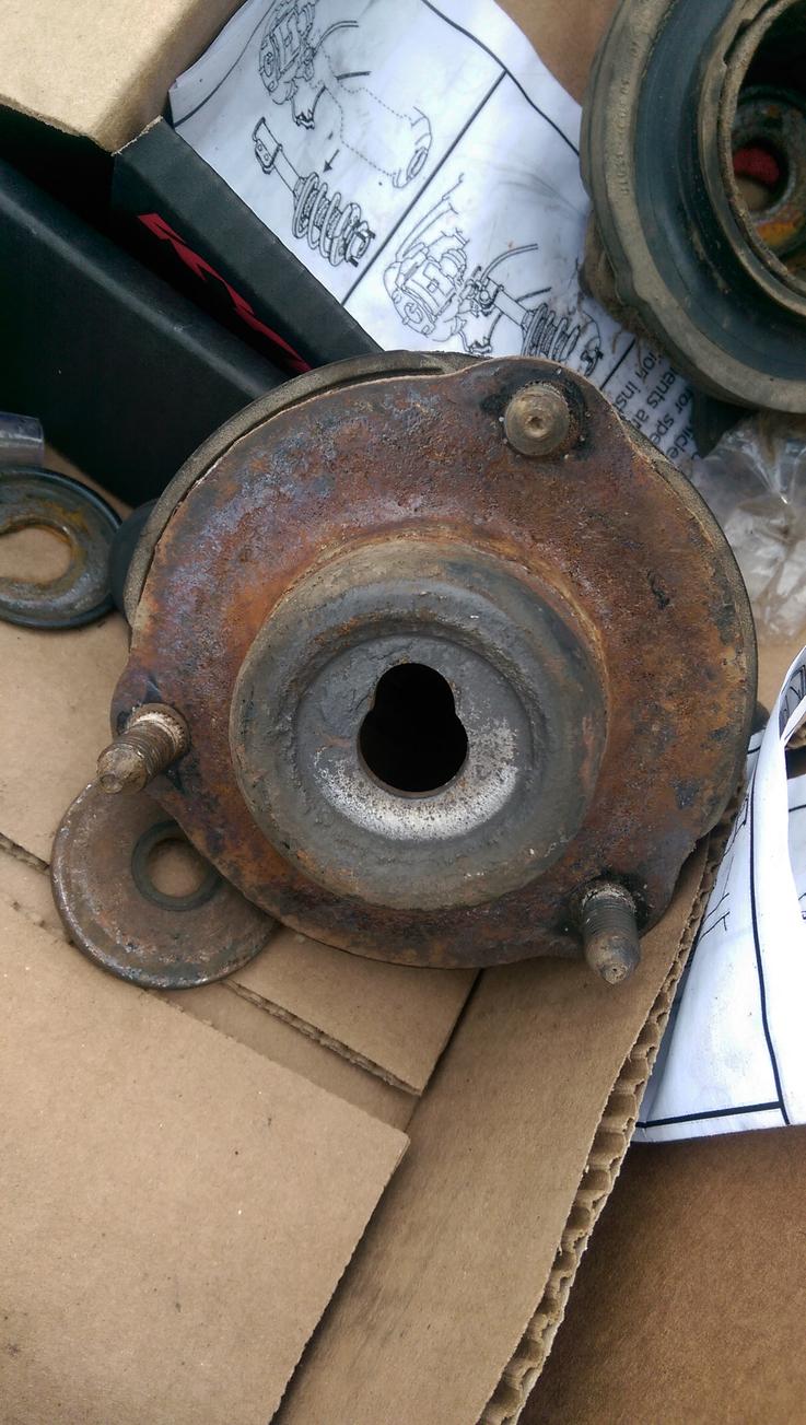

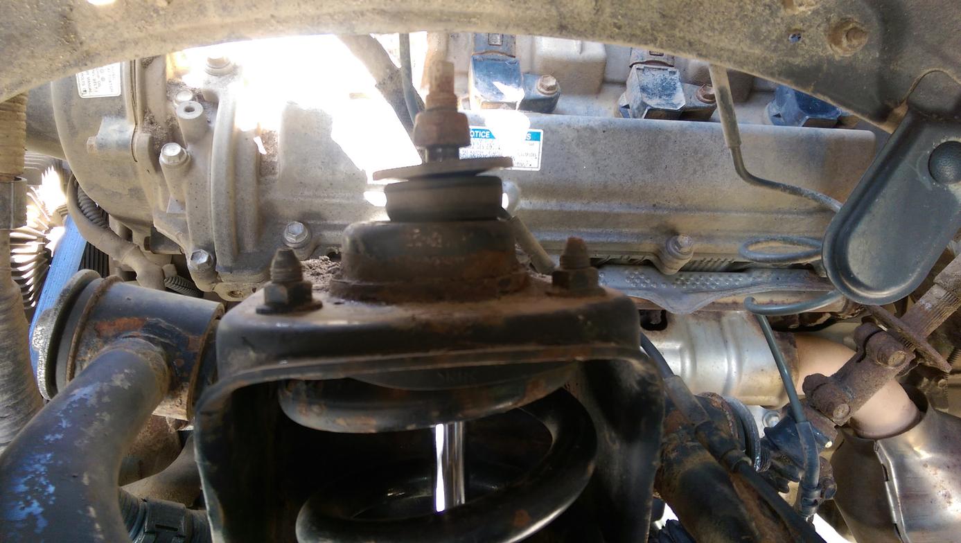

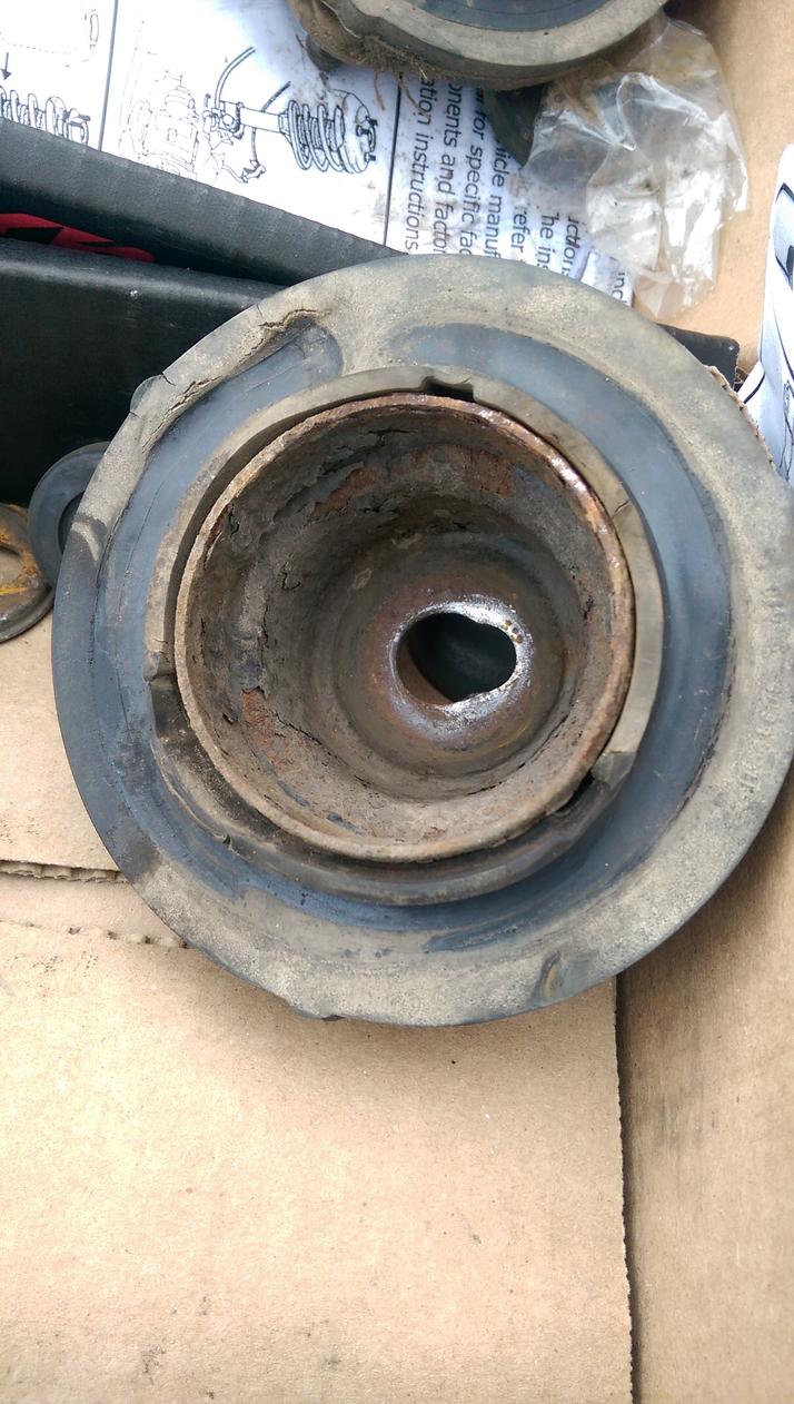

Here's what my tophat looked like.

There is no reason to replace top hats unless they are broken like the ones above. They are not a wear item.
