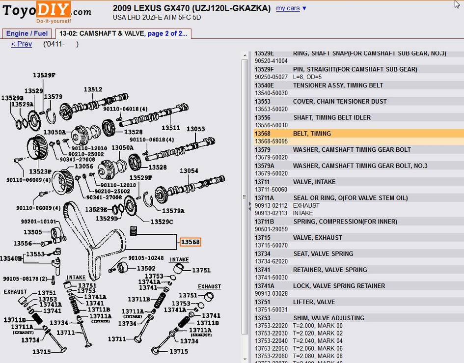

It is definitely a timing belt, not a chain. There is not one single parts store that sells a chain, no pictures available anywhere that show it with a chain or any other evidence at all for a chain. Several forums have asked the same question and those that have suspected a chain have always been proven wrong.
It is odd that the Lexus site does not list the belt replacement, however every other maintenance schedule website that I looked at did.
2008 GX470 Maintenance for 90k
2009 GX470 Maintenance for 90k
All straight out of the Lexus website. How does this make any sense? For 2009 they started using a chain? Or belt but don't recommend on changing it?
maybe that is when they started moving to that 4.6L v8. Have your buddy pop his hood and see if it says 4.7L on the engine cover...
It looks like the 2007 GX470 has 3 more horsepower (1.1% more) and 17 more foot-pounds of torque (5.6% more) than the 2007 4runner V8 based on edmunds specs. I wonder if it's a different engine tune or if the engine will automatically run that way on premium gas?
4.7 2UZ-FE = BELT = 2003-09 V8 4runner's gx470's and tundras. 05+ most all models received the vvti upgrade. Different internals between state side and japan made engines.
4.6l 1UR-FE = CHAIN = 2010+ gx460, tundra and up to 2012 sequoias
