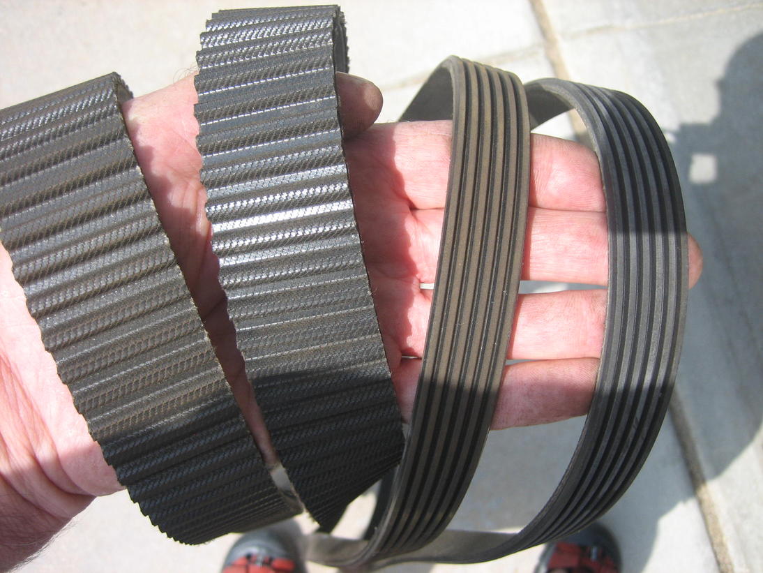

IMG_5308.jpgJust changed the timing belts, water pumps, serpentine belts, pulleys, tensioners & spark plugs on my 06 4Runner Sport V8 & my wife's 04 GX470., GX
4Runner 83k miles, GX 63k miles.
Same engines, except the 4Runner has VVT & the GX does not.
I was worried about age of belts. The timing belts & the serpentine belts all looked fine. No visible cracks or wear. The 4Runner had a minor water pump leak. The GX was fine.
Plugs looked fine. Installed new Denso iridium's.
