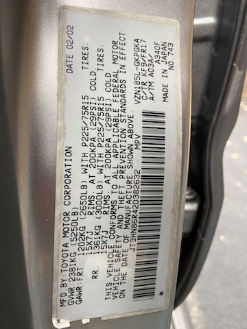

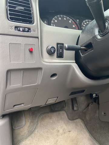

With the following pics, do I have an e-Locker and what is my gear ratio?

The rear diff capacity is 2.6 quarts w/o a locker and 2.9 quarts w/ a locker
So 2 quarts isn't super low. I agree with with Randy it was damaged or on on its way out before the welding took place. 2 Cups low wouldn't damage it.
