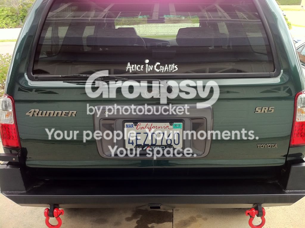

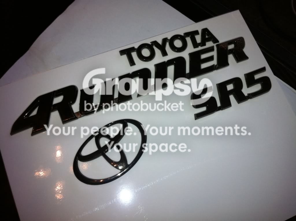

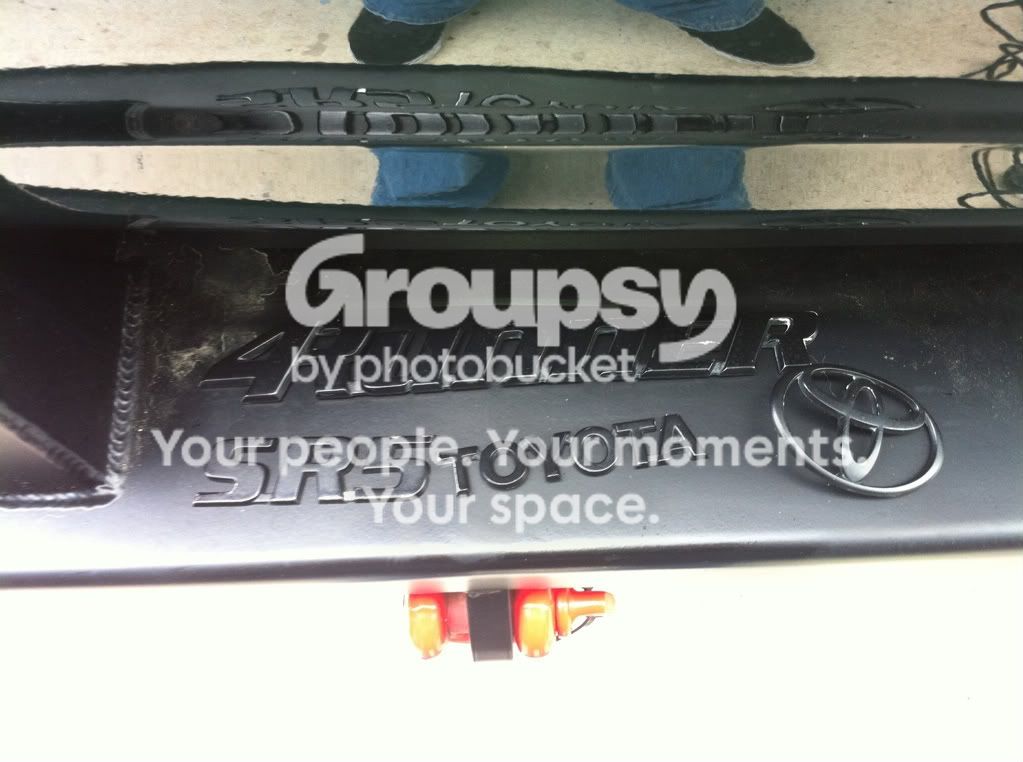

<a href="http://s1231.photobucket.com/albums/ee515/HI_LIFE1/?action=view&current=IMAG0220.jpg" target="_blank"><img src="http://i1231.photobucket.com/albums/ee515/HI_LIFE1/IMAG0220.jpg" border="0" alt="Photobucket"></a>
<a href="http://s1231.photobucket.com/albums/ee515/HI_LIFE1/?action=view&current=IMAG0232.jpg" target="_blank"><img src="http://i1231.photobucket.com/albums/ee515/HI_LIFE1/IMAG0232.jpg" border="0" alt="Photobucket"></a>
Yep Plasti-Dip right over the paint. I used a toothpick to get into the areas between the letters. Super simple and NO effect on the factory paint.

Dude that looks sick on the license plate part!
Thank you

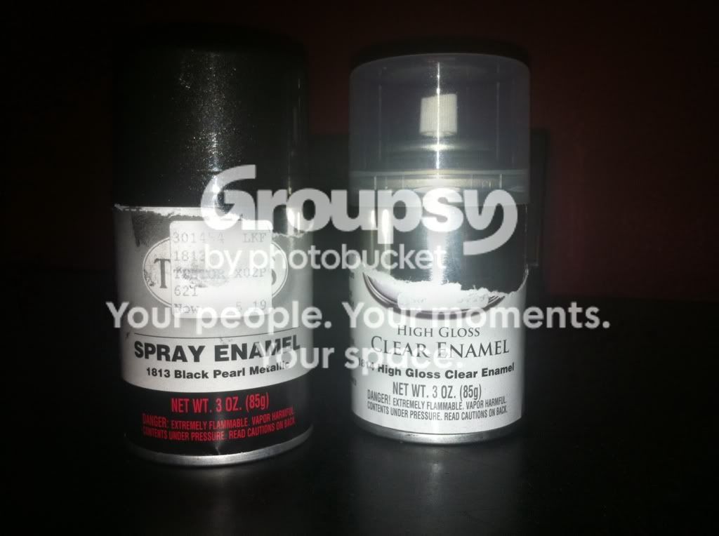

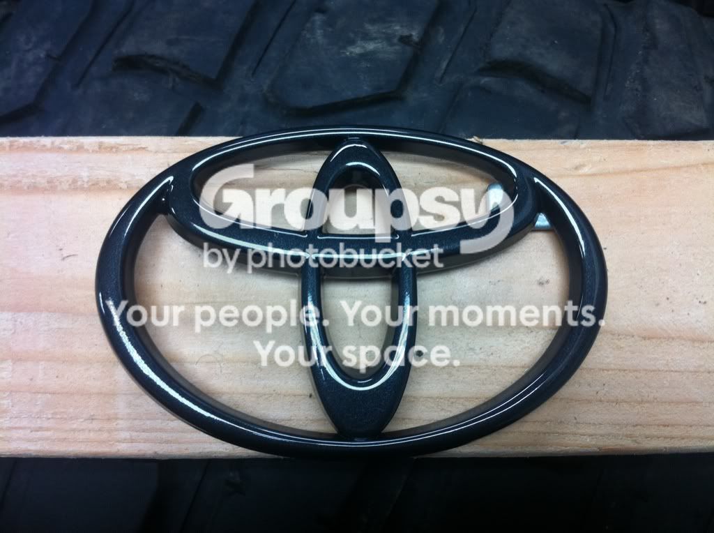

I took mine off and painted them with ordinary spray paint, primer, clear, etc. They held up for a long time until I took a buffer to the truck.
If I had to do it again, though, I'd use some Testors spray enamel and clear on all of them.
I found myself a set of black pearl rear emblems off a truck at the yard. Too bad the front emblem was gone (crashed), but I painted the front with Testors #1813 Black Pearl Spray Enamel and #1814 High Gloss Clear Coat.

Black Pearl Emblems:
28920f4a.jpg~original
bbbb2e44.jpg~original

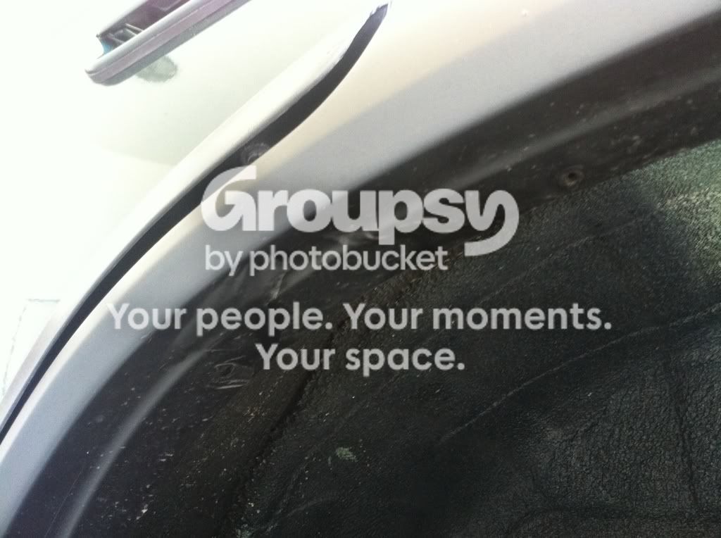

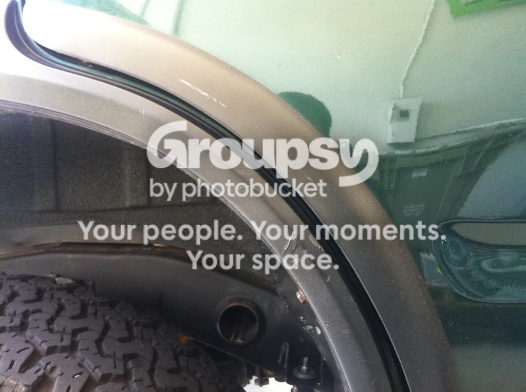

My experience shows that the only positives to Plastidip are temporary, such as a great look, easy application, and easy removal.
I just don't like reapplying plastidip often. I have already done my flares twice and my bumper twice, and even after 5 coats of plastidip and 2 coats of clear, it still manages to get screwed up.
For example, the rear flare is screwed up from passengers and unloading stuff in and out of the back seat:

Here's another spot. If you take it to a wash, or apply any type of gloss dressing, the plastidip literally melts.
27211dc9.jpg~original
