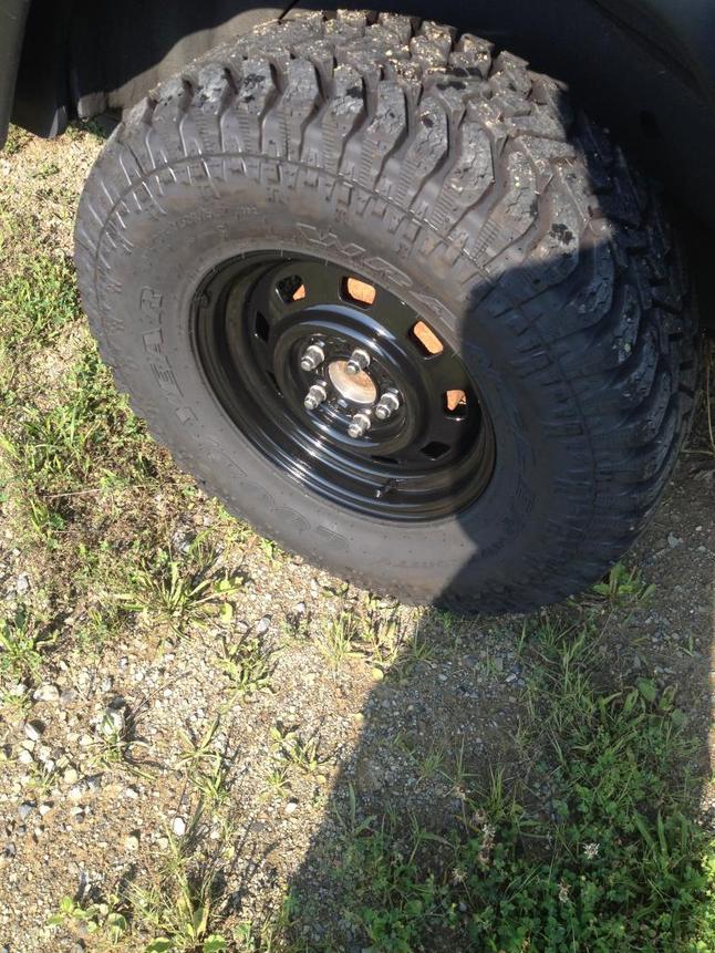

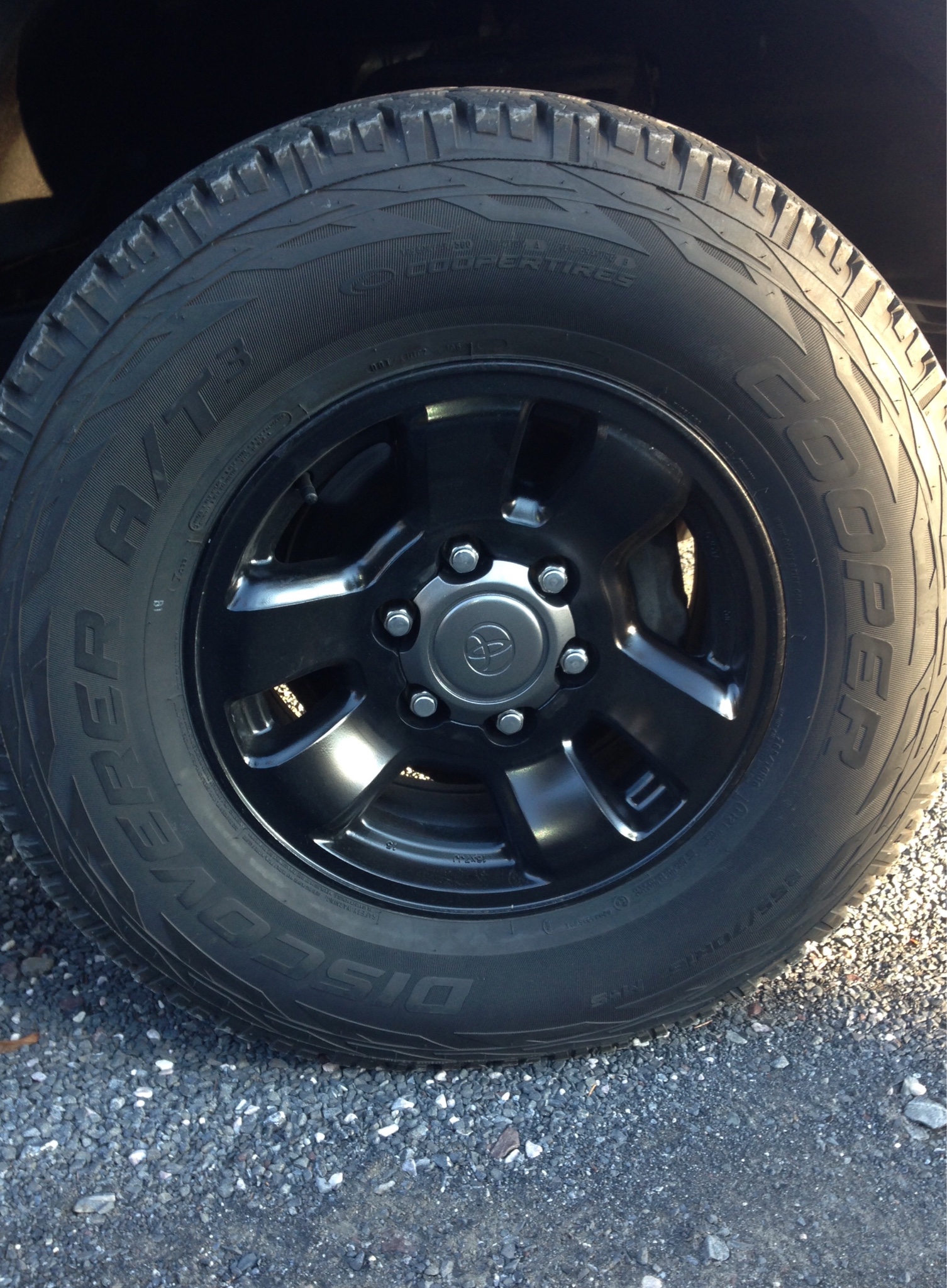

I did the wheels on my wrangler with 6 coats and no clear. They look the same today as they did in 2013.
