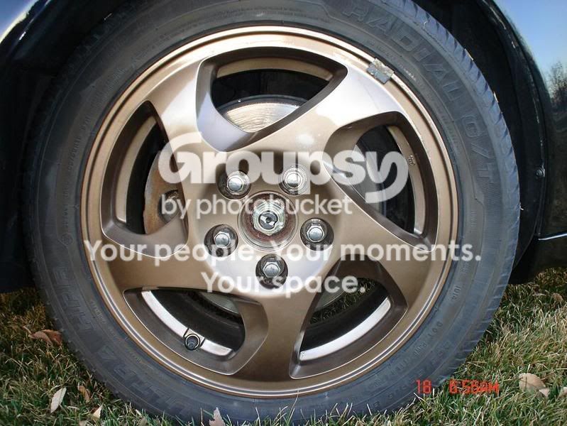

btw, I was actually planning on doing this myself and i'm not sure now. since you have done it. :P I think I might do bronze or gun metal
this is the bronze i used on my prelude
ya3.jpg~original

Tacticalcustoms: Thanks for that link. I'll have to look into getting better tape for future endeavors. Do you think it'll really make a big difference (due to the nature of plasti-dip)? Anyway, I like the bronze wheels on your prelude. What color is your 4runner? If it's silver, I'd definitely stay away from bronze :P
