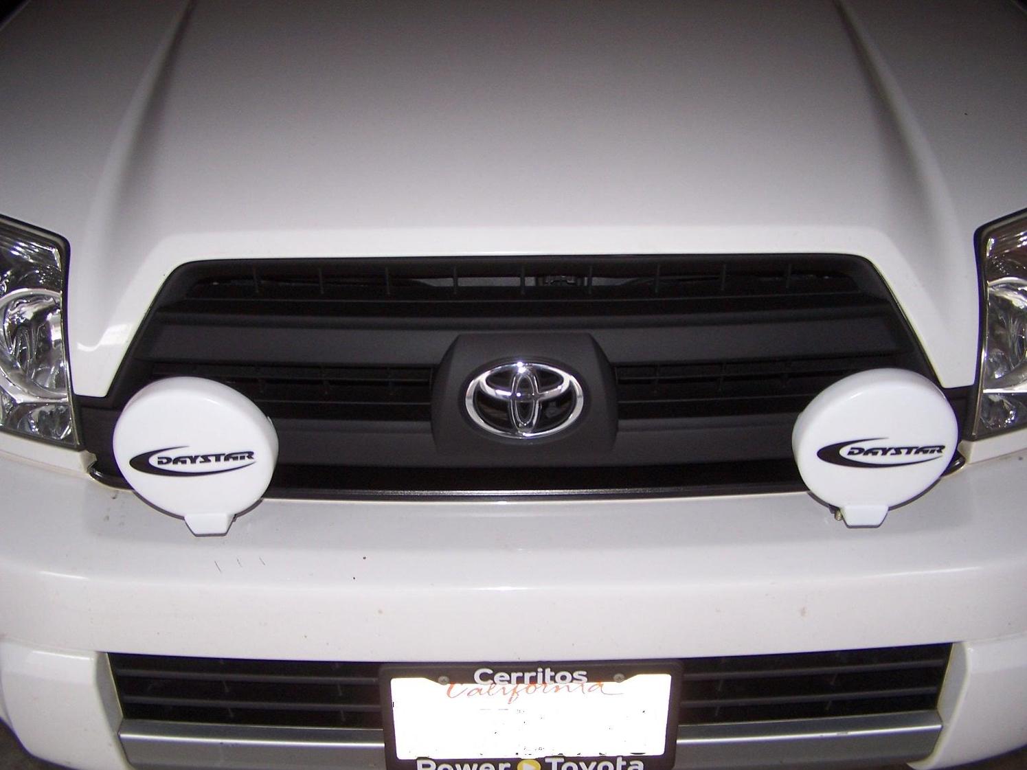

have you thought about just spray painting it? Its rather simple to do.
I guess I'd consider it. What paint did you use? How many coats and any recommendations? Any sealant after you spray it? Why not powdercoat it? Just lots of questions if this is going to be a DIY.

Or just buy an ABS insert from ebay and paint it black like I did... I just got to pop it out and there it is....my stock color match grill...
I think I paid about $36 for it.

I sprayed mine black and I've been quite pleased. I always knew that if I wanted to make it back stock, I could just buy another chrome one from the dealership and I can't imagine it being too expensive.
