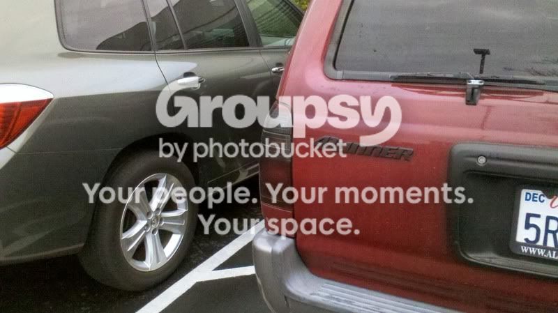

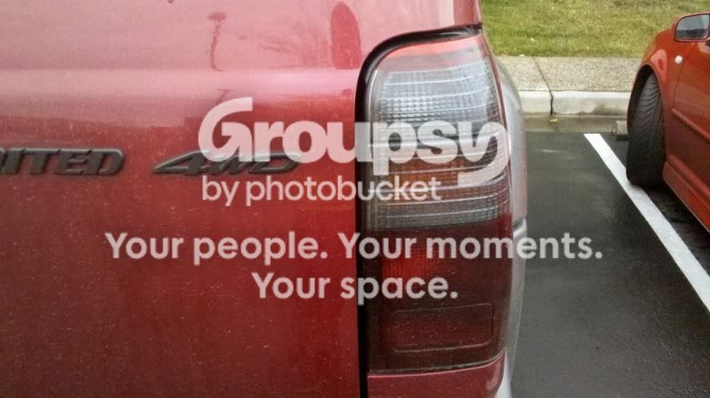

I did mine with VHT, but very lightly. It basically just made the red a darker red rather than black. I like it a lot better than the all black some people do. I will get a picture up later to show you. It doesn't look factory, but I had an extra set of taillights that had scratches anyways. So I can switch to stock anytime I like.
The pictures as promised.
2012-02-07_15-45-38_159.jpg~original
2012-02-07_15-45-49_354.jpg~original
