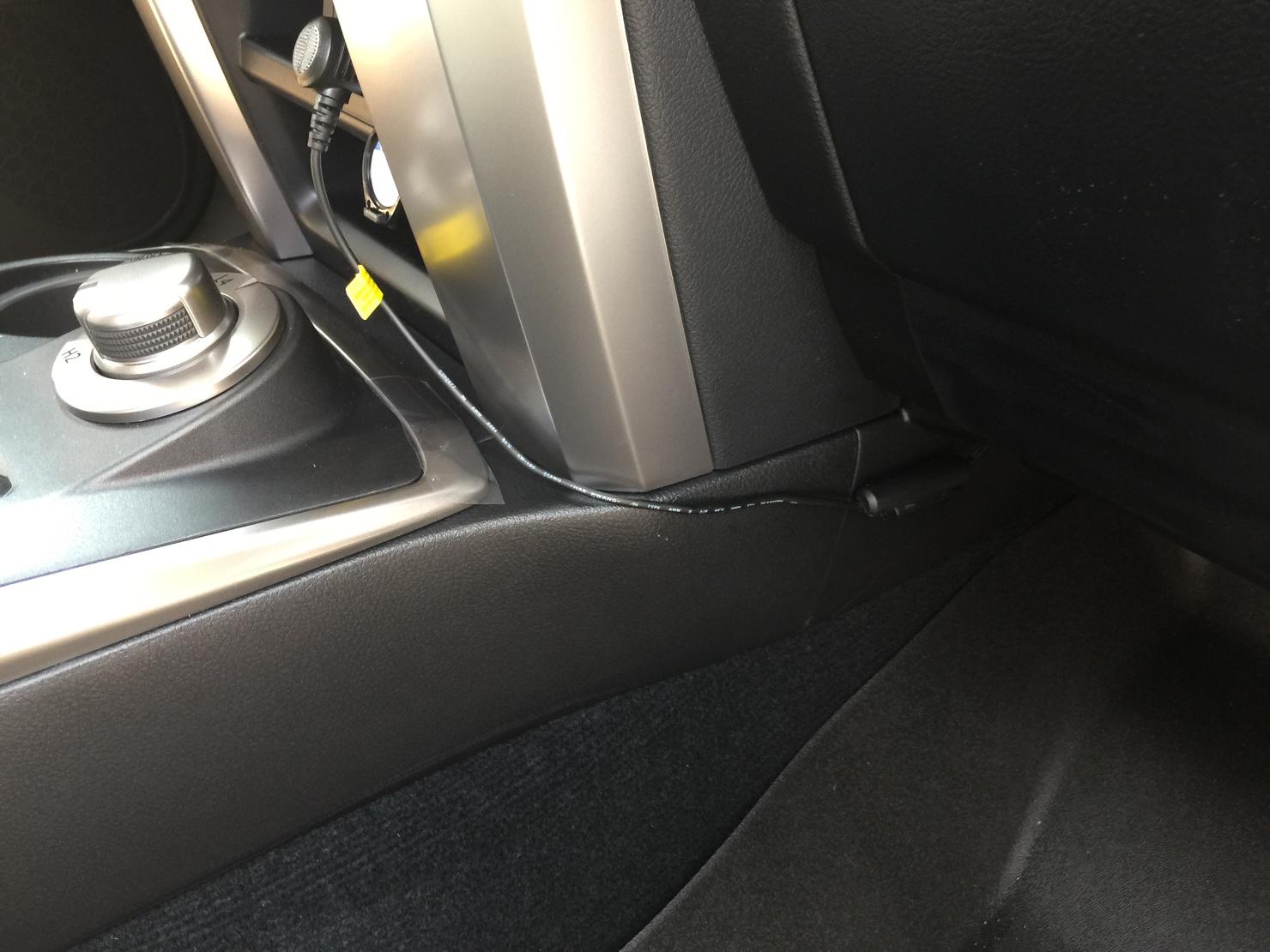

Finally got around to finishing up my install of my dash cam. It has both front and rear cameras and records in 1080P for the front and 720P for the rear. Install was super simple, just ran the wire for the rear cam under the edge of the headliner from the back of the truck to the front. Wire comes out where the mirror wires are and into the front camera. Never even had to take off any of the interior trim. Power is connected to the accessory plug in the center console by the USB plug. Sorry for the multiple posts but for some reason I can only upload one pic at a time. Now for the pics:

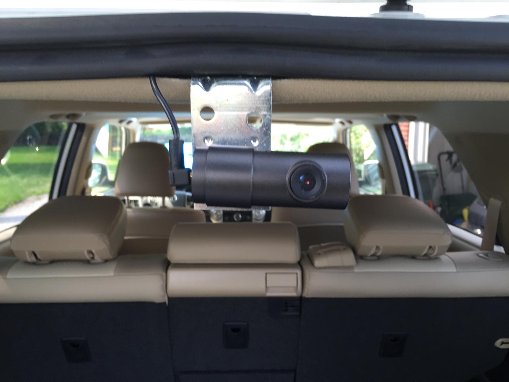

Rear camera is removable for when loading tall items. Just disconnect the wire and slide it out from the headliner.

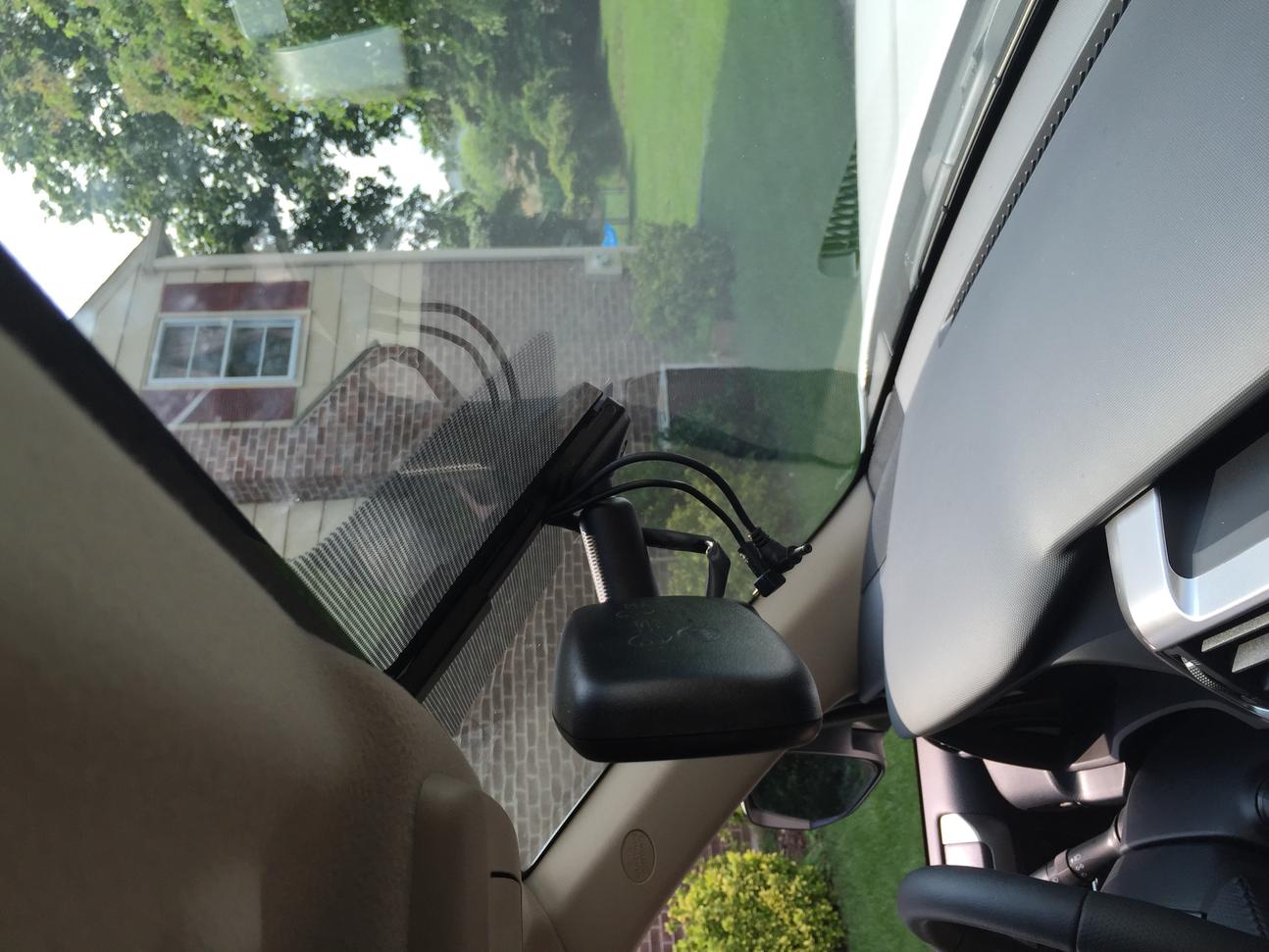

Wiring for rear camera and power source are tucked under the headliner and come out where the mirror wiring is.

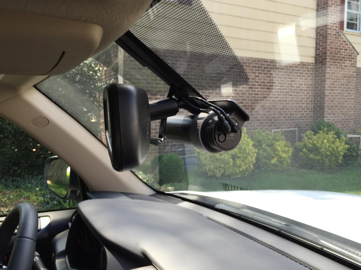

Front camera is stuck to the windshield via supplied 3M tape. Also shows the wire connections to the unit.
One last pic of the front camera a little further back. Video is crystal clear and can include info such as speed and GPS location. Also includes WiFi for viewing video on your smart phone via an app.
