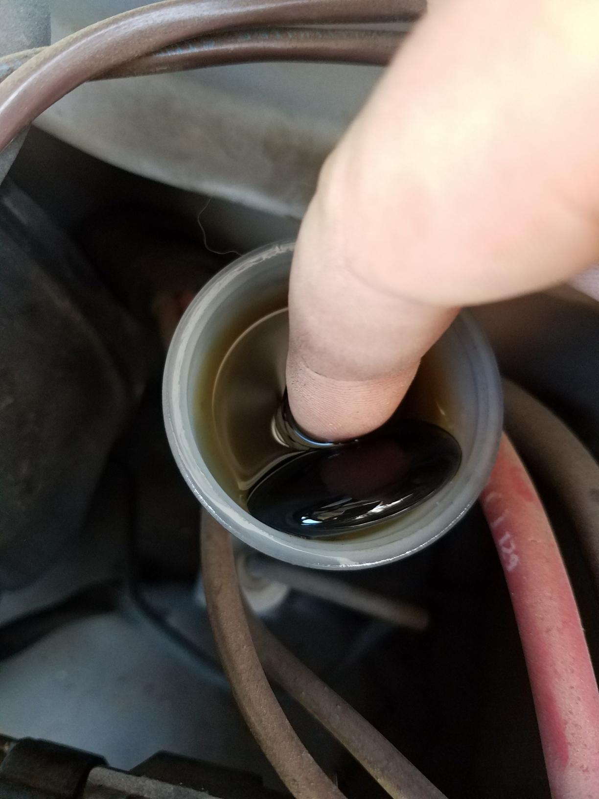

So you don't have one of these? With the cap off and bleeder out it should flow by itself. You may have to find a friend
