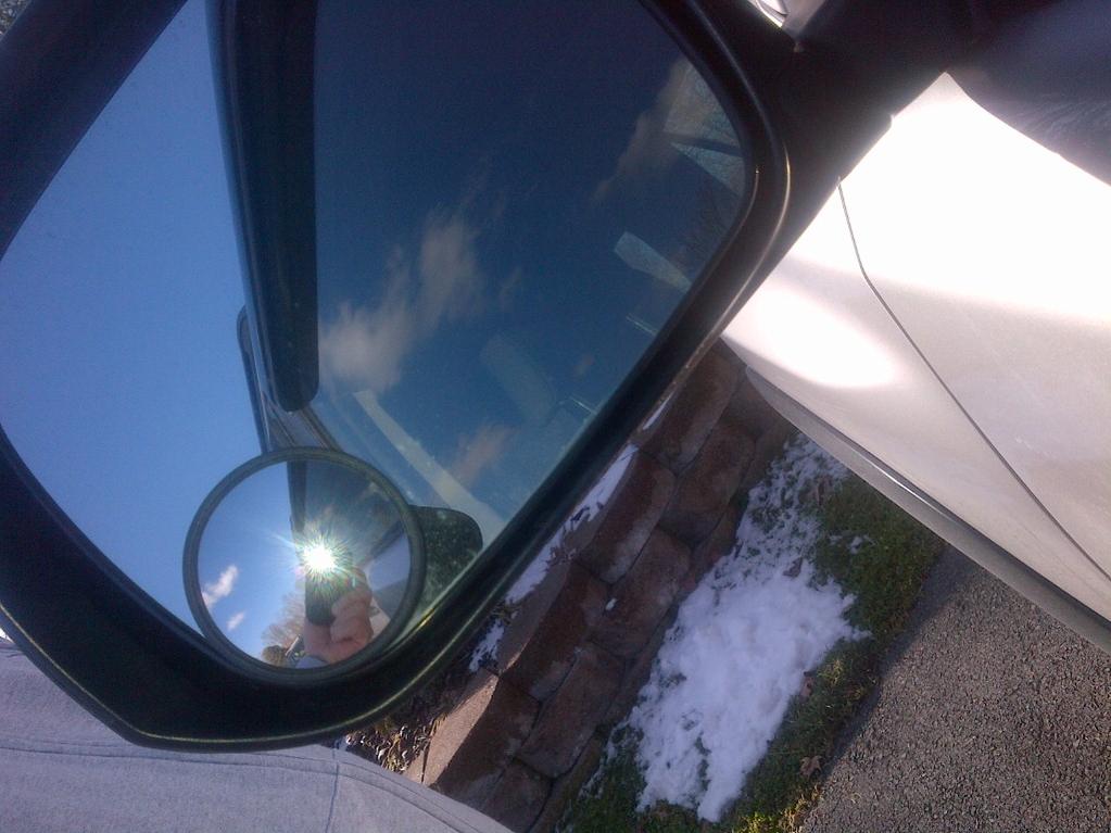

No wires, no fuss. Works every single time. Even identifies what type and color of vehicle is in your blind spot. Only problem: Cost. It costs between $2 and $3 depending on where purchased. That's for the pair. It does require you to be semi responsible for yourself though and actually pay attention while you are driving.

I know I know they are old man mirrors. Do me a favor though: Try them sometime and you will be surprised.
