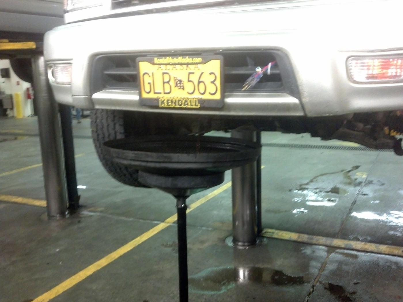

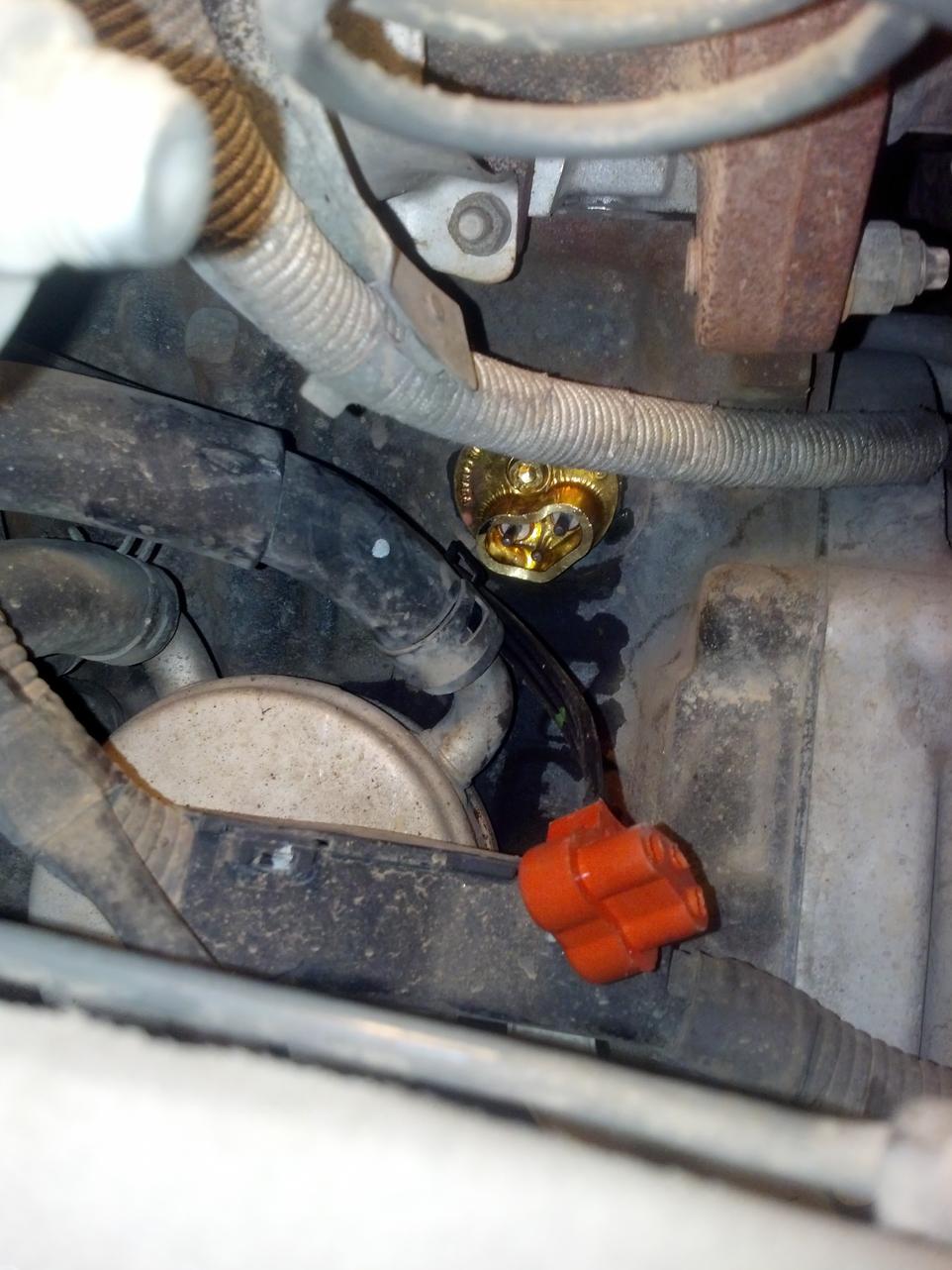

First thread so bare with me. Pictures are attached.
I just put a block heater in yesterday and ran into a problem with the coolant. I drained the radiator and the engine block, popped the frost plug out and installed the block heater. And when I went to add the coolant I put it in the white container next to it assuming the hose going to the radiator would suck it up. Keep in mind this is my first time.
Now to the problem, I then filled up the white container and ran for about 5 minutes with heaters on high. I was watching the container most of the time and saw it bubbling but it wasn't being sucked out. I saw the the temp gauge get to half (operating temp) and killed it. I then poured the rest of my coolant in the radiator, steam came out for a couple minutes. I went to go start it and it'd idle for a couple seconds and shut off. I let it cool for about 10 minutes and tried again. Had a rough start but it eventually sounded normal. Now I know now I read something wrong and I was supposed to run water through the radiator while I was doing it but what's done is done.
So my question, having run the engine for about 5 minutes without coolant actually circulating, did I do any damage? The gauge never went above halfway but it wasn't starting for awhile.
