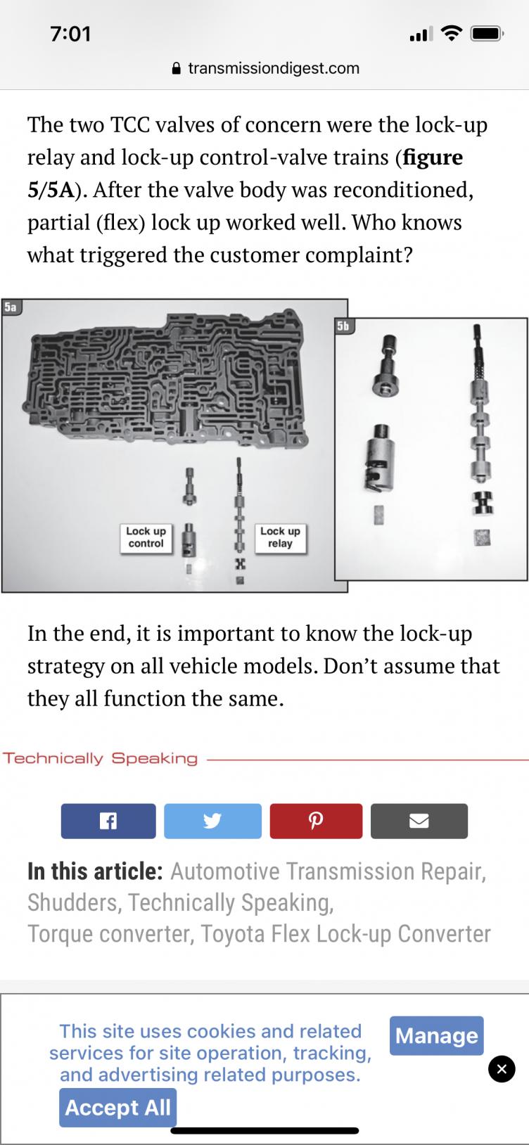

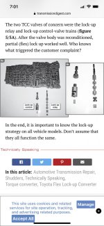

My 2017 SR5,at 48,000 miles, got first a new torque converter then 3 weeks later a new tranny due to a faulty TC FlexLock mechanism inside the tranny valve body. I was outside the 60 month Power Train basic warranty, but I had purchased a Platinum Service Agreement extended warranty which covered the $8k dealer billings. This experience shattered my belief in the Toyota Reliability myth.
This screenshot was from my internet research on my shudder/chatter drivability issue.
