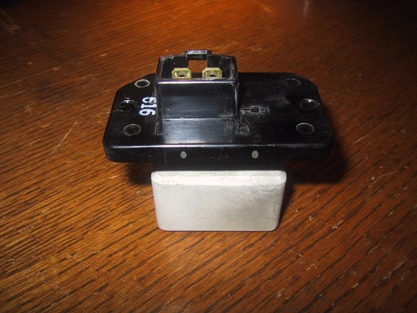

I think I've got the resistor....
Is this it?
It looks a little different than the ones in the 80's trucks, but that looks about right.
If replacing it didn't correct the problem, may be it's the switch itself. Usually when the module goes, one of the coils (resistors) opens and that speed doesn't work at all.
Must be the switch itself then.
I thought it had to be the resistor b/c it works in that switch position...but just not at the right speed.
