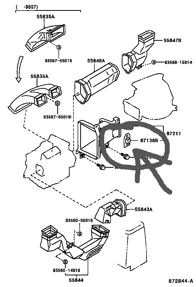

the blower resister went out on you. Mine did the same thing. I think it was $20ish for a new one and about 10 mins to swap it out.

Picture of Blower resistor.
And link for it with part number and price.
Click on Illustration 2 of 4
