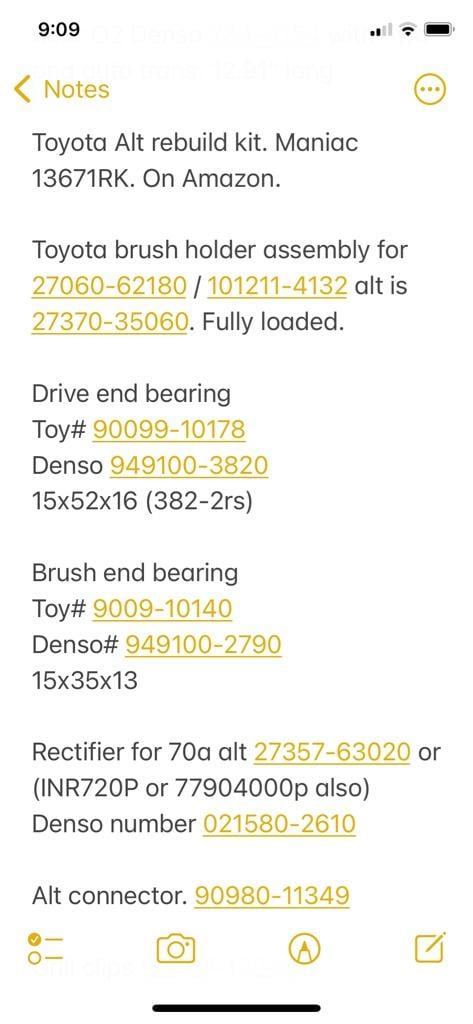

Is there a part number for that set?
Do you know which Alt you have?
I think the 27370 number is a fully loaded 70a.
Edit: the two part numbers before the last number are the OEM and Denso part numbers for the Alternator. I’m pretty sure it’s for the 70a Alt. The 80a Alt is totally different.
Good info. Are the bearings that come with the Maniac kits made in China? Guessing that's why you have the other part numbers listed. I always assumed they were and just bought rebuilt Denso alternators
The Manaic kit I used just for the VR. It was made in China. Didn’t feel like spending over 100 dollars for an OEM or napa voltage regulator for the sake of troubleshooting. The VR is still going strong. The problem ended up being a bad diode in the bridge…..
