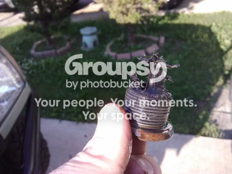

Blown. Front. Diff.
Think about it... LSD requires spinning... that can hook up all of a sudden an break stuff. Doing the same with a locker will break stuff as well, but you are much less likely to have uncontrolled wheel spin in the first place. If rocky terrain is what you normally traverse, then fully locked might be a better solution, whereas you may be more protected against drive train damage with an LSD in the mud where spinning is required. Your truck and your call... but be sure to conduct exhaustive research. Replacing a CV takes 20 minutes on the trail, and you can get one with a lifetime warranty from O' Reillys ;) Replacing a front diff is very difficult on the trail and quite expensive, comparatively.
OTOH, an LSD in front with a selectable rear locker will get you through anything reasonable, and you wil find that 1st gear is plenty low to crawl up the tough stuff. The slush box makes this quite an easy process, just be sure to learn your truck and "listen" to its ques... don't go too fast... it will not want to... don't go too slow... your tranny will get hot a bothered. :D
I agree.
If he doesn't let uncontrolled wheel spin happen with the Tru Trac he won't break anything. Drive into the obstacle using two feet and most of the time the Tru Trac works pretty good.
Exactly my point... why not a selectable locker? If you are worried about front stress on a lip... leave it open and bump up. You would also have the option to lock up the front and crawl, without having to play the momentum game with two feet. Just sayin'
If he broke his front diff when it was open, he will break one with an LSD...
IMHO that break was all driver error.
I agree that driver error played a part, but certain modifications would have made the breakage avoidable. After reviewing the video, I would say something had to give... trying to scramble up a tough ledge with open diffs!
(Think I've played enough armchair QB today at this point... I was not there... I'll just leave it alone at this point :) )
