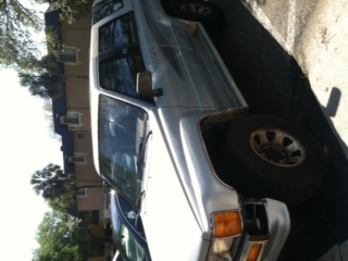

I have a 1997 4 runner limited with the following Vin #.
Could you please send me the information on recall?
Vin JT3HN87RXV711869. Has blown head gasket.
