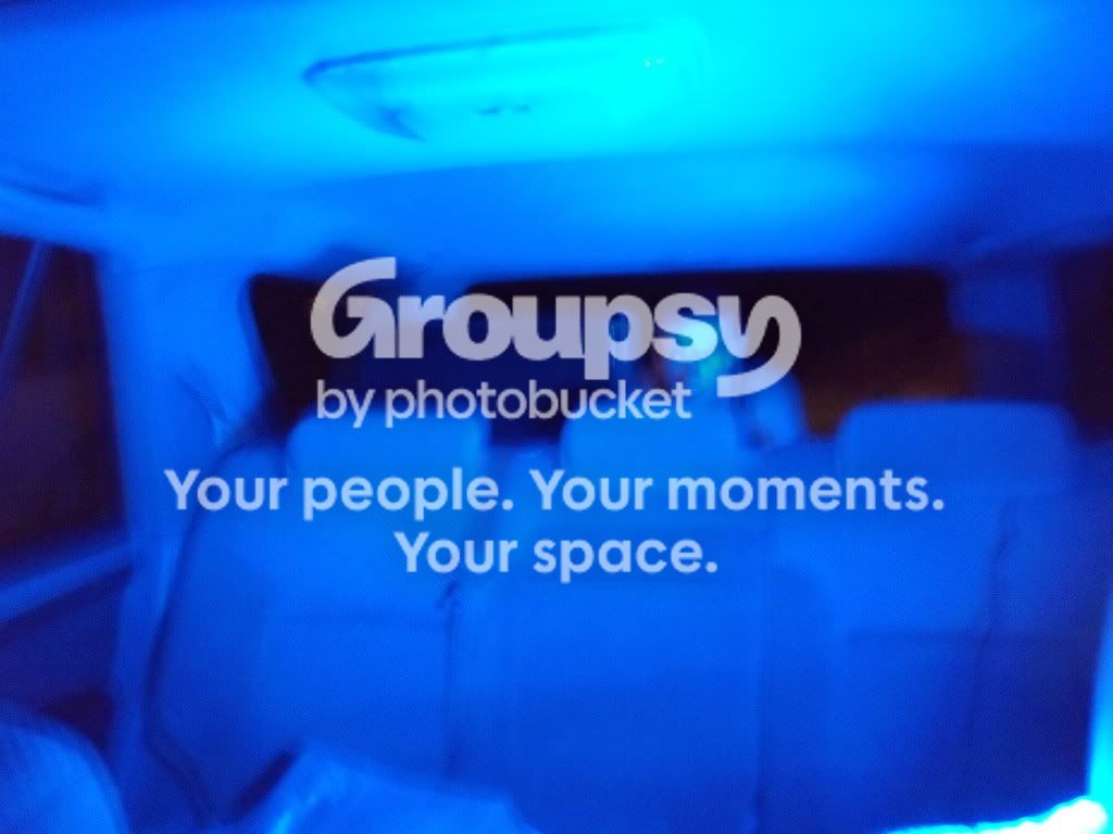

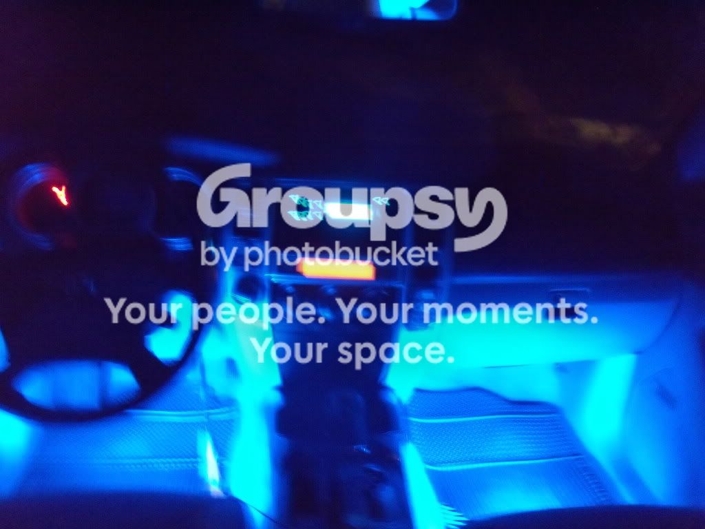

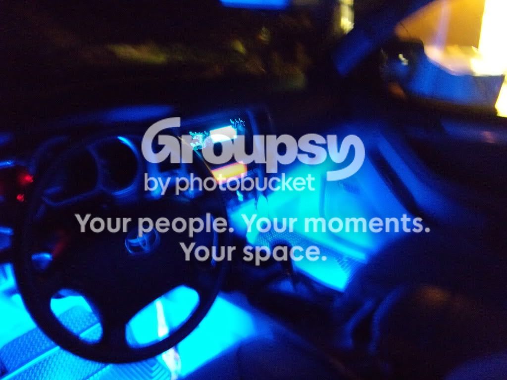

Anyway, I thought I'd finally give back. Here's some pictures of the interior of my 2004 SR5 - if anyone wants to know more about what these are, where there from, how to wire, etc. feel free to ask! :thumb3:

They are bright definitely, but when you look from outside when they are on, you can't tell there are even lights in there...

What i did is i popped off the trimming around the shifter - pretty easy, make sure the center console door is open when you lift it up (very easy). and how i wired it is to the BACK of the cigarette lighter. in the kit you have a red wire, your constant, and a black wire, your ground. i stripped the constant on the BACK of the cigarette lighter, stripped the ground, and then tied my THREE constant wires together with a wire cap (red wire with kit, white wire cut in half = 3) and did the same with the ground wires. you can get pretty creative with where you put the controller, the lights, etc... i hope that kind of makes sense..
