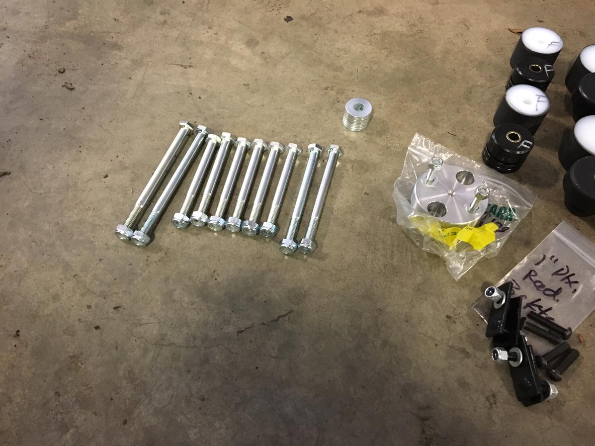

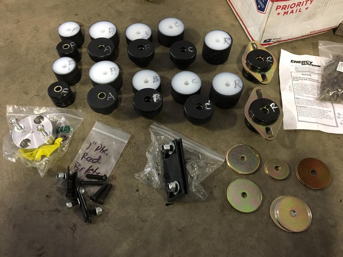

So my 4crawler kit came in last Thursday. It includes poly body mounts (including the B pillar mounts that the '96 didn't get from the factory), the spacer blocks, steering rag joint extension, metric hardware, bumper relocating brackets, and radiator relocating brackets:

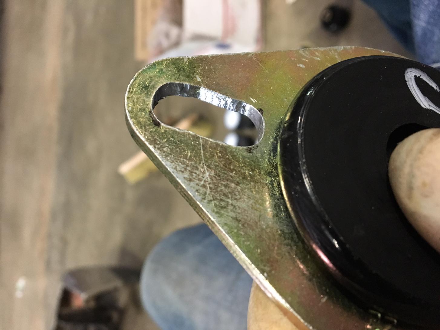

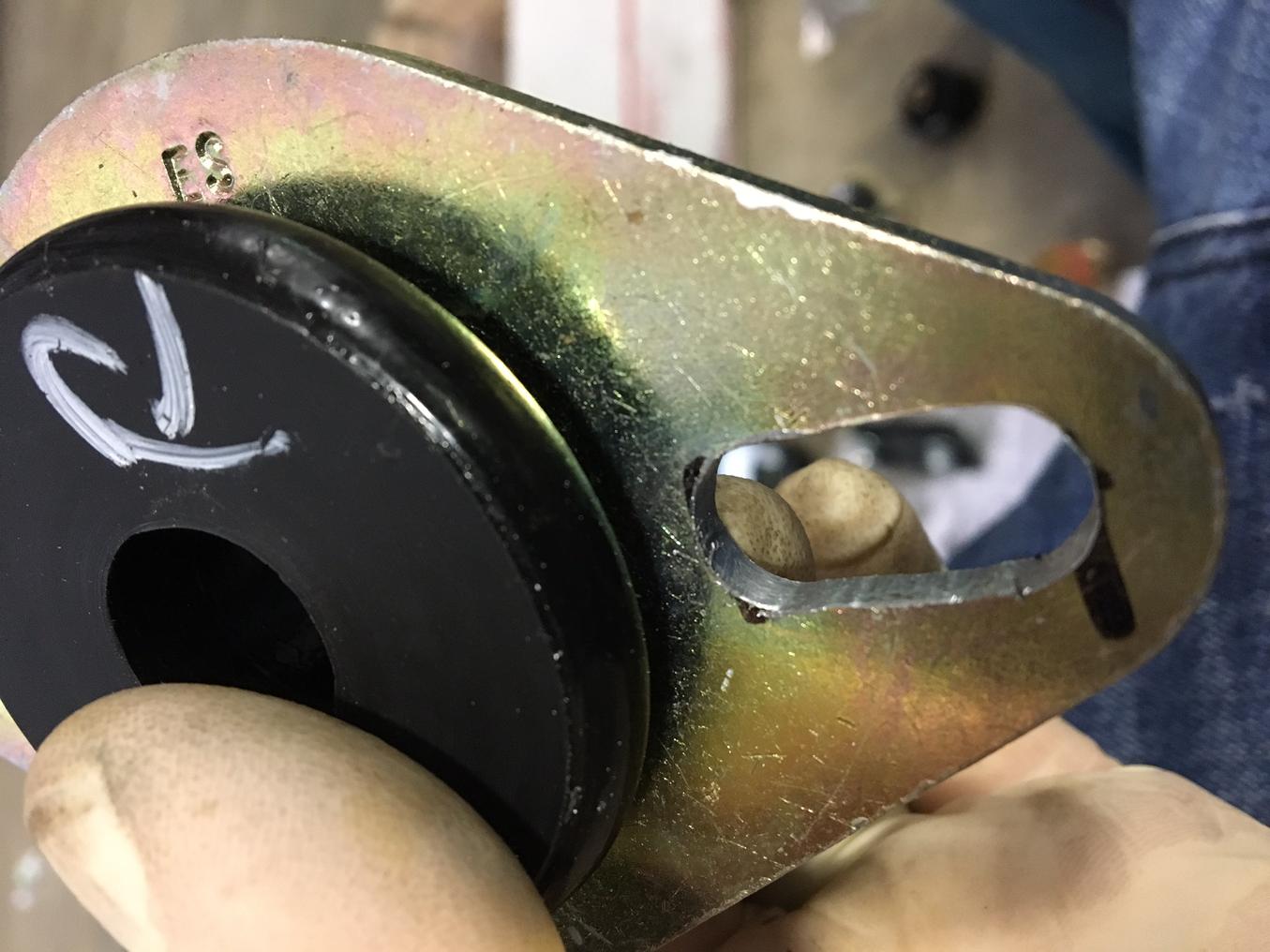

All in all, a pretty nice kit - but the repurposed Energy Suspension rear mount brackets are kinda hokey at this price point, IMO.
I will end up reusing the factory hardware on the A&C pillar mounts, so as to retain the locking tabs on the bolts - look like their lengths are just fine.

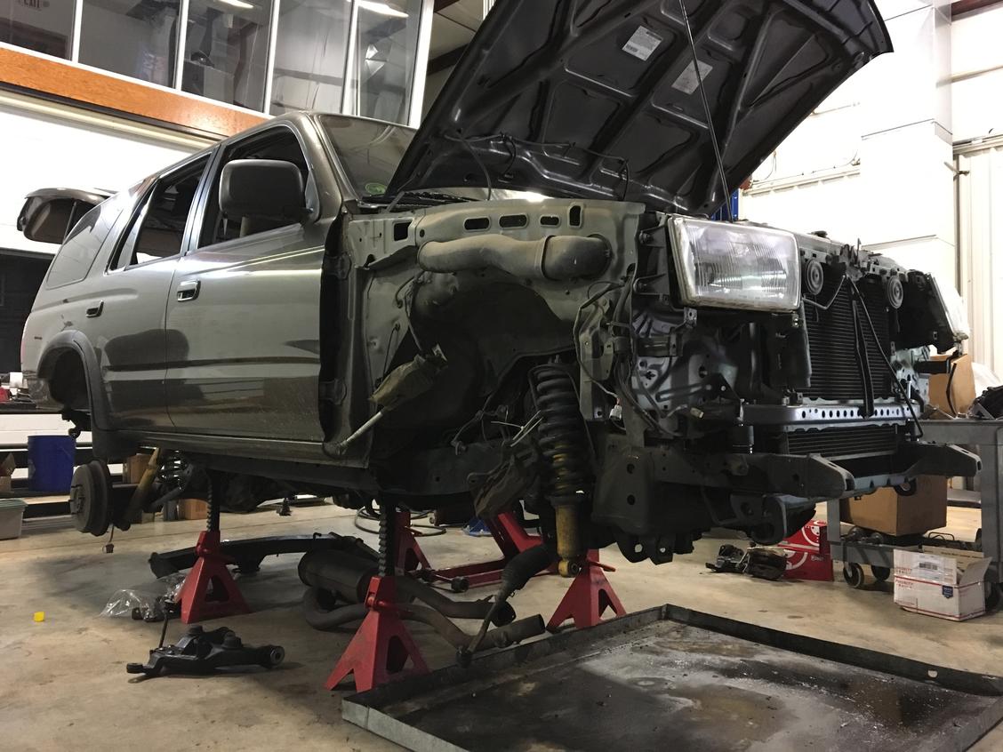

I also had to use a considerable amount of heat to free the bolts on the rear mount on the driver's side - will replace the factory hardware in both of these mounts.
I'll also need to do a minor pull on the radiator core support up front to get a good alignment with the frame mount on the driver's side - my truck was hit in that corner and it tweaked the core support
