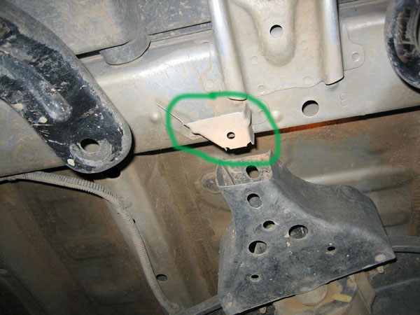

Spare wheel compaprtment adjustments
For those of you with a Body lift please advise. I have a 2008 SR5 model. I dropped my spare to change my Rear Diff fluids and add the Breather. I was inspecting my tire pulley system and it does not look like it has the metal guide hanging from the body like on the install pictures. It is just an opening with a lip at the entrance all parts seem to be on the frame and the only concern would be that the rear bumper opening and the pulley system will not allign properly? Anyone with an 08 have a problem after bodylift with dropping the spare?
This is what i thought i would see, i guess i do not need to do this part if or when i add a BL.
you just take a hammer and beat it flat to the body or grind it off.

Thanks for the reply Crazydubman, it looks like a straight forward install. I have never done it before but i am sure that i can when i get a proper floor jack with out air tools though. The only things i am looking at twice is the Rad drop,steering spacer and now the tire pulley because on my 2008 model it does not have the attachement on the body that needs to be hammered out. It looked like a black metal box with the system inside of it all attached to the frame so i was confused when i saw this missing the metal part on the body. I guess that i will not need to do anything to it in this case.
