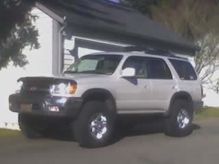

Any Suggestions where to find a body lift for a 2000 TR4? Any issues to worry about for installation?
