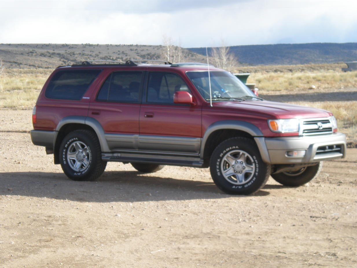

'01 limited with all the flares and junk...
How hard is it to remove the fender flares and door moulding? I'm not sure I want to keep the flares and body moulding...if I do I'm gonna get them rhino-lined, but I might just ditch all the flares and stuff and rhino-line the body itself depending on what it looks like with the stuff off. Would also like to do the bumper covers.
Also, any ideas on the lining itself...rhino lining vs. line-x vs. the do-it-yourself bedliner products at the autostore??? Spray on vs. roll or brush? Really don't know if I can do it myself or if I should bite the bullet and have someone do it.

You can't remove your flares! The rear ones are will leave holes in the doors! But the fronts come off nicely!
2nd that. If you ditch the flares it won't look good! You'll have to plug the holes, then rhino line over that. I'd just rhino line them as is... Use the search function for ideas. Many guys have done this. Good luck!
Appreciate the info.....especially glad I found out before I started trying to rip stuff off!
Flares are very saleable, as you may have already found out, so be very careful if you do decide to pull them off, and don't go just ripping into them.
I've been there and had them off, and I have to agree with the other posters, just leave them on there, they look good.
The only thing I like was that with the flares off, the wheels/tires stuck out quite a bit from the fenders, so it really gave the truck an agressive looking stance, but it's all an illusion, and you can accomplish the same look, with the flares on by doing wheel spacers, or rims with less backspacing.
