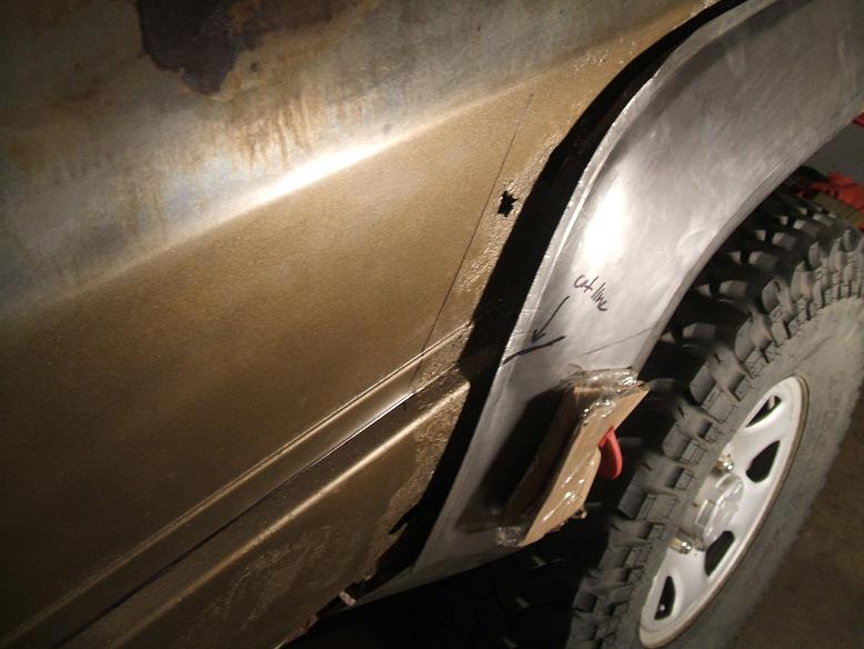

I looked at replacing the quarter panels on my 86 about two years ago. I looked at the metal and fiberglass panels. The full metal replacement was a three piece a fair that looked way harder to install than the fiberglass. I order the metal but after not being contacted for three months I ordered the fiberglass. It took about three months to get the fiberglass panels but the salesman I talked to was great. Good instructions came with the panels. I found that it is easier to cut the old panel away with a air chisel and grind off the spot welds with a 4" grinder than to drill out each spot weld.
I used automotive adhesive and pop rivets to install panels with very little trouble. Unless things have changed be prepared to wait for your panels. Shipping is about the same for one panel as two so order both at the same time.
