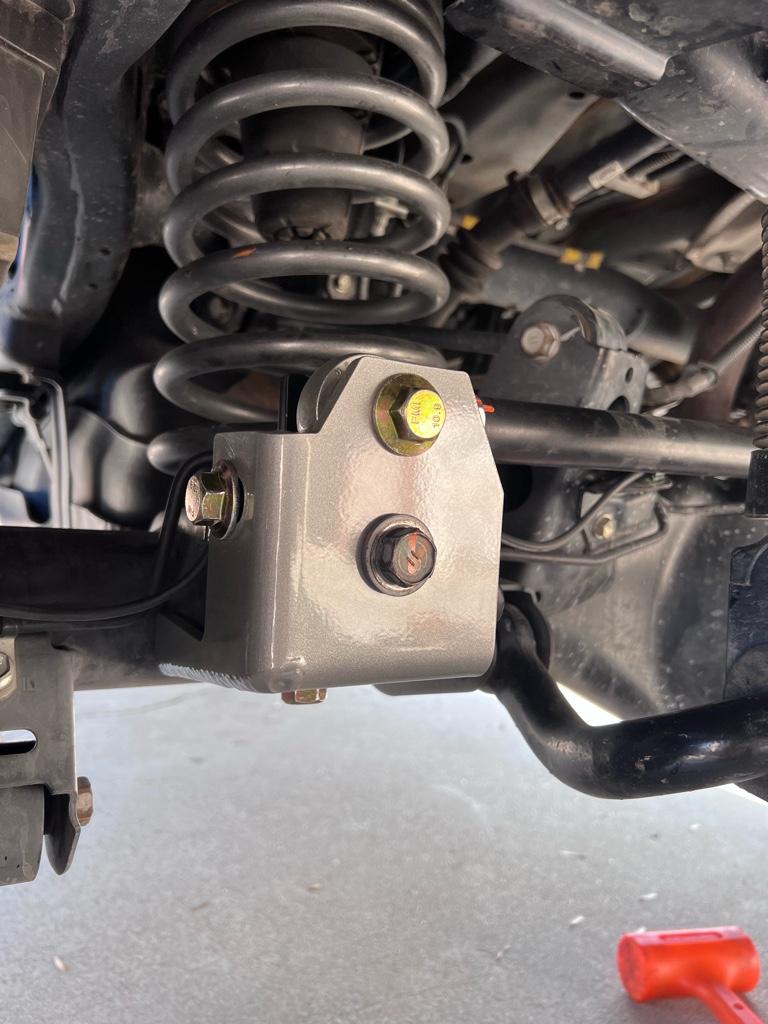

Bolt on Pan hard correction Kit BOPCK
And last which is the most important part … imagine the color options. Forget the function [emoji1787][emoji1787]. I’m just playing.
king blue boiiiiiii. now cut the top hole out cause its gonna hit at full compression if you actually drive it like you mean it. and send me one to test for free. dont even weld it, i can weld that sh1t up. :humble::humble:
seriously though, in the Ford world alot of guys prefer the track bar drop brackets instead of the longer track bars. OEM geometry is desirable, but i guess thats more important on a front end with steering. i'm running a carli bar, and it feels identical to the stock bar with a cheap drop bracket.

I think I will offer a shorty option for the Guys that want to boogie.

Another 2-3 weeks max. I’m just about done cutting them all and they are being bend and all test fitted on the fixture I made to make sure each one is exact. They should be headed to powder coat next week or so.

Shorty version for my not so tall ride height guys that like to go fast [emoji1605][emoji1605][emoji1605][emoji91][emoji91]
