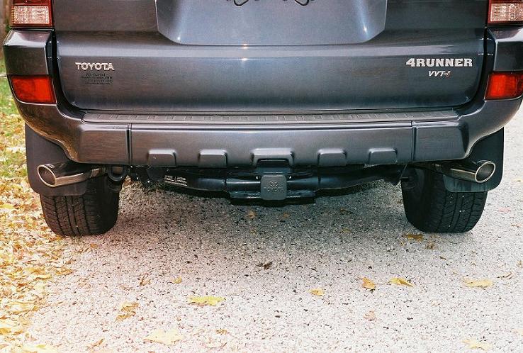

I have the Borla exhaust on my 2006 with the V8 ,Dealer installed option ($800)and it was pretty loud inside the vehicle at 70-75 on the freeway. I added some additional sound material to the rear which did not help. I had my local muffler shop remove the front resonator and install an 18 inch straight thru Magaflow. I then had him cut the tips off which are small resonators and rerouted the exhaust out the back. I now have a very mellow sound which does not get annoying after a couple hours on the freeway. Hope this helps.

Bobd,
Can you post some pics of your system, especially the reat piping coming straight out.

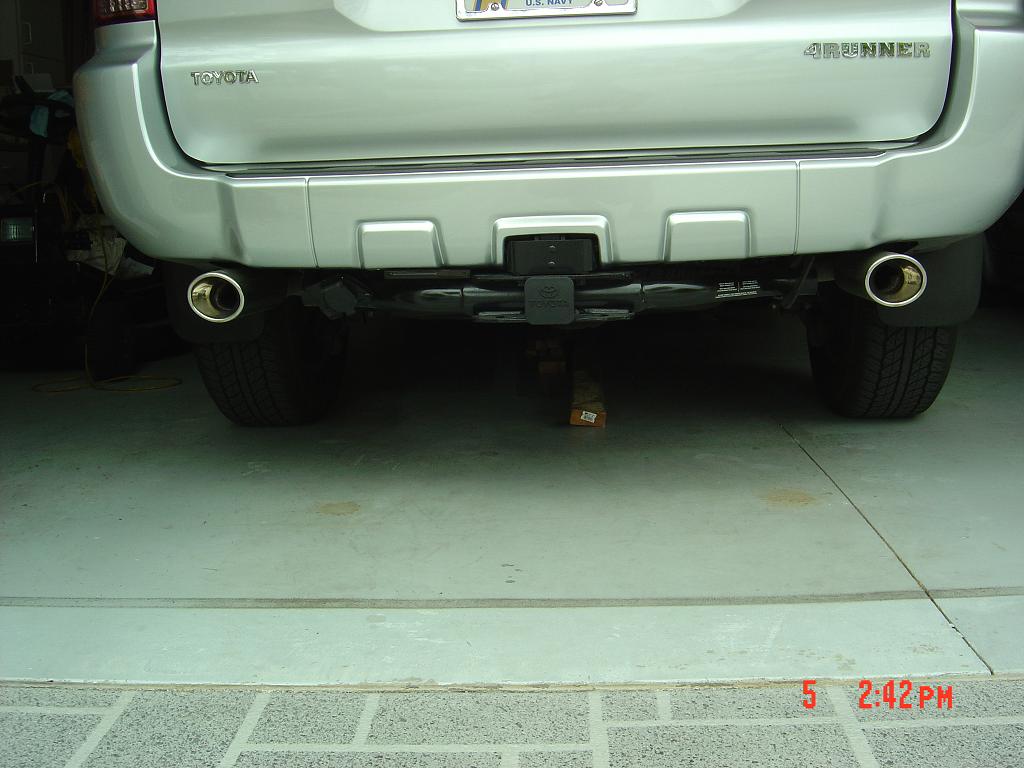

BORLA EXHAUST
I do have the Borla exhaust, stamped BORLA both tips and the muffler.
I will try to send the picture again.

Wow.........That looks awesome. Now that might just be somthing to try out.
I have to talk to some of my buddies who know someone at an exhaust shop.

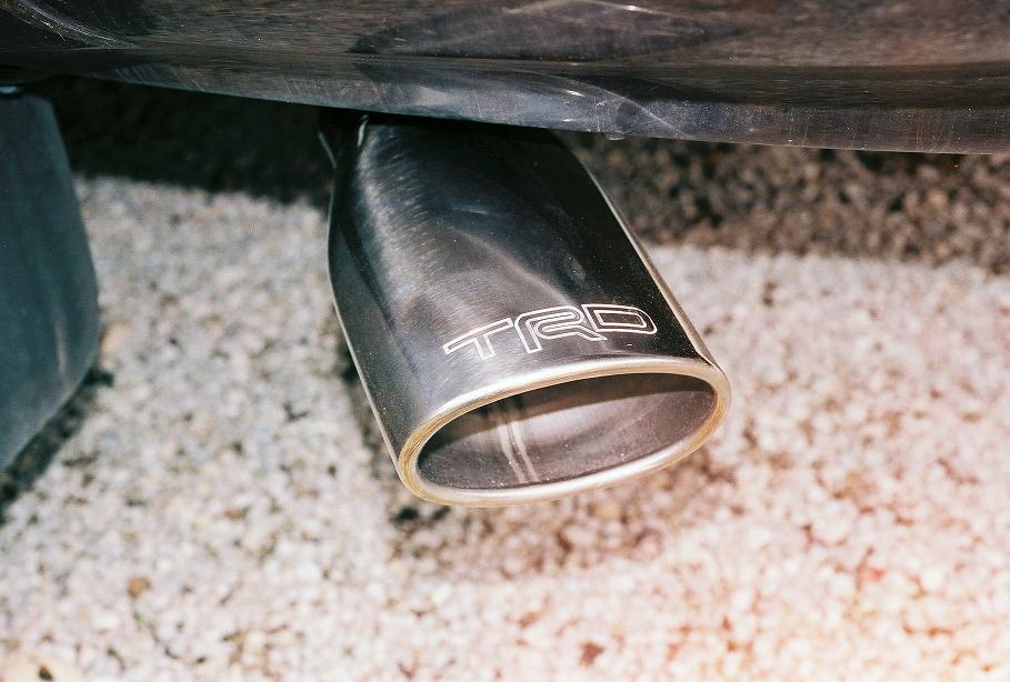

I've got the TRD-etched dual outlet (but really a single pipe with two outlets) system. Always had heard that it was manufactured by Borla, but don't have any evidence to confirm that.
The system had to be slightly modified to get it to fit, but I still have my spare and it looks good. It has a little drone at about 1700 rpm, especially in overdrive and a light foot on the gas pedal (corresponds to about 55-60 mph). Above that rpm and at higher highway speeds (65-70 mph), it's actually fairly quiet. When you tromp on the gas, the noise from the back is balanced by the noise from the front (the K&N intake)! :D
