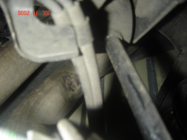

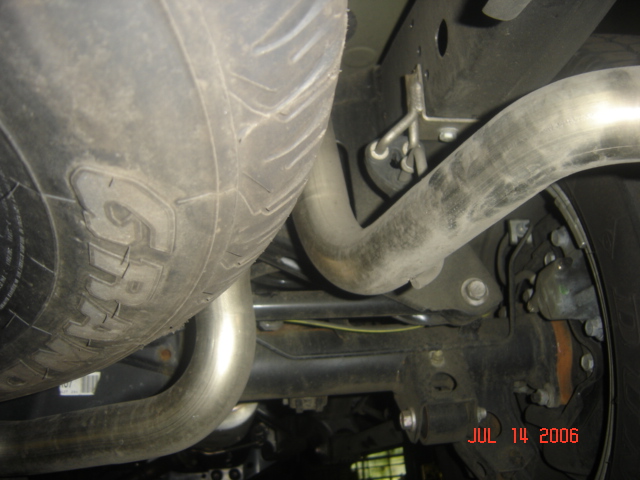

Had a question(s) for you guys I know it's been a while since I've been here asking questions. I notice a while back when I have heavy load or if I hit a low line slope in the ground I here something hitting from the bottom of my 05 v8 4runner. I also brought my borla exhaust system from Tad from Courtsey Toyota. Took it to Toyota today I got on the lift and the Tech guy and I notice that the right side mandell pipe have been bent or has a rubbing groove in it. The tech guy says the everytime I have a load or hit a ditch the borla pipe hit the rear rocker arm in the back and tthat the noise I have been hearing. Has anyone else experience the samething or did they mount the exhaust the wrong way on my 05 v8 4runner.:awais: :bash: :confused:
I don't know what kind of clamps were used with your system but you need to loosen the claps and move/shift/turn the pipes so they do not touch. What happen to your exhaust is it was set-up without knowing that at full susp. compression it would hit. A slight adjustment could be the difference between hitting and not. The Magnaflow system uses stainless strap clamps and can be readjusted if newly installed. If regular clamps were used you still may be able adjust it but you may have to use WD-40 and work the connection back and forth until it moves. Do this ASAP! Good Luck.
Koz
Koz
Are the hangers/bracket holders surpose to be inline with each other? From the back to front hangers/brackets. The front 2 hangers/brackets are inline meaning straight connections but as you get to the back the muffler shift to the left more. It resulted in the right center pipe coming from the muffler to lean over the rear rocker arm of the suspension and once I have poeple in my truck or if I hit a ditch the pipe hits the rocker arm.:(
If you could take a pic of your system and where the problem is someone could maybe see where the problem is and/or how to correct it.
koz
I took some pic today. You can see the spot where the rocker arm hit the right pipe leading the the exhaust. It the back looking towards the front of the truck. The pic is showing the right leading to the right exhaust tail pipe which you see in the second pic. The body shop is telling he can correct by welding a new bracket to pullinng whole muffler to the left moving it away from the metal edge.
