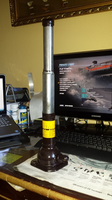

The 5th gen Bottle jack extends quite a bit. I as surprised how much the 4th gen actually extends (it is a dual sleeve bottle jack.) It almost is able to completely lift my 4th Gen with 33" tires and a 3" suspension lift.
The 5th Gen unit should be the same design as I don't think Toyota changed it for many years., so if you're not able to lift a STOCK 5th gen with your bottle jack, it is either not being extended enough and/or you are not lifting on the frame.
This is the 4th Gen Unit fully extended to a little over 19" tall:

OP, please open your owner's manual and read up on the factory jack points and how to use the stock bottle jack. I used to have an 07 FJ with the same bottle jack with a 3" lift and 285 tires, and all I needed was a 1/2" thick piece of plywood for the jack to sit on, and it was tall enough to change tires on my lifted FJ, so youre doing something wrong.
