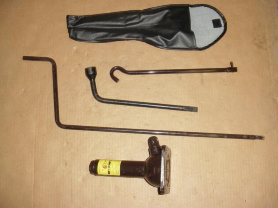

I cant help at all with your question, but doesn't that come with the telescoping screw type jack? if it does, it should go more than high enough. they extend way out.
The photo I am attaching is the jack setup for the 2000 SR5. I have control arm skids and the jack doesn't even touch that.

It definitely will. It double-extends. You don't put it on the body, just on the arm. In the rear, it goes under the axle, not the body. For emergency purposes, of course...
yep, that's the one. it will definitely go up high enough. I think it has 3 sections. it goes WAY up. much further than you would expect it to.
I use the same one on my 85, its got 6" of lift, and 37's. lifts it easily.
Super interesting. I put it under the arm and it just stopped going up when I used it. That may be because I have a skid plate on it which is at an angle, while the jack is flat. Either way, probably user error then! haha.
