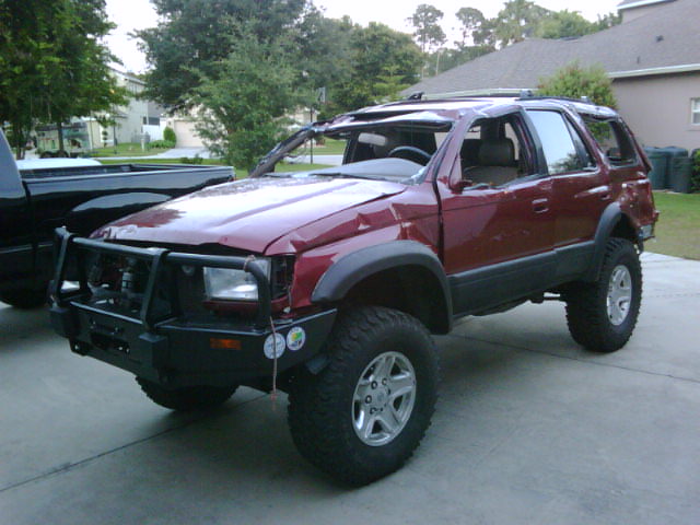

I bought a 96 4runner and have some questions about it. The owner said it had a 3" lift but he did not tell by who or whom.
Here are some pictures that was able to take. Is the lift any good? Is it worth transferring to another 4Runner?

:wow:The spindle got ripped out! Holy crap!
Blue/yellow are Bilstein colors so guessing those are up front. Never seen a lock plate like that on the adjustable though. Weird. Dunno, hope some one can help with the ID on the lift.
I'd say the lift is good to go. Clean it up and give it a little rattle can action.
Mannn, judging by the look of that front right tire, I'd say that his truck was either way overdue for an alignment, or had incredibly bald tires and took a turn too fast, or both. Suspension parts in question look OK from pictures. Look like adjustable Bilsteins? Not completely sure. I'd say sandblast the paint/rust, protect, then re paint and install. Did he mention how long he had the lift installed for before the accident? Was that extra front strut not installed on the truck? That front left strut (shock/spring) might have gotten bent in the accident. I'd say you could at least use the rear lift parts. The front looks like a combo of a thick spacer lift and an adjustable height shock, which is fairly uncommon from what I've seen in the past. It's either usually one or the other, not both. If you don't mind me asking, how much did you pay for the totaled 4R?

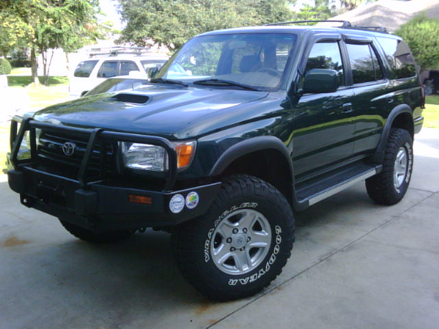

I bought my rolled '96 for a grand, but it had the E-locker, 3" OME lift, and an ARB bumper. I put all that but the E-locker on my '99.
I'd say the lift is probably fine, and if you part that thing out you should more than pay for the lift you will move over to another vehicle.
