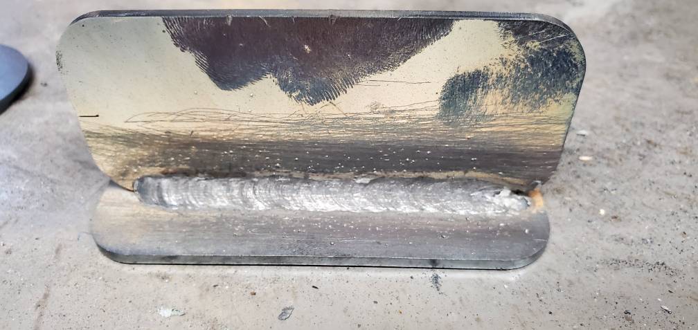

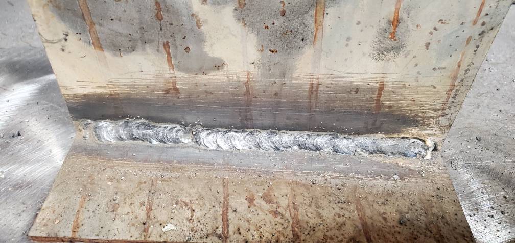

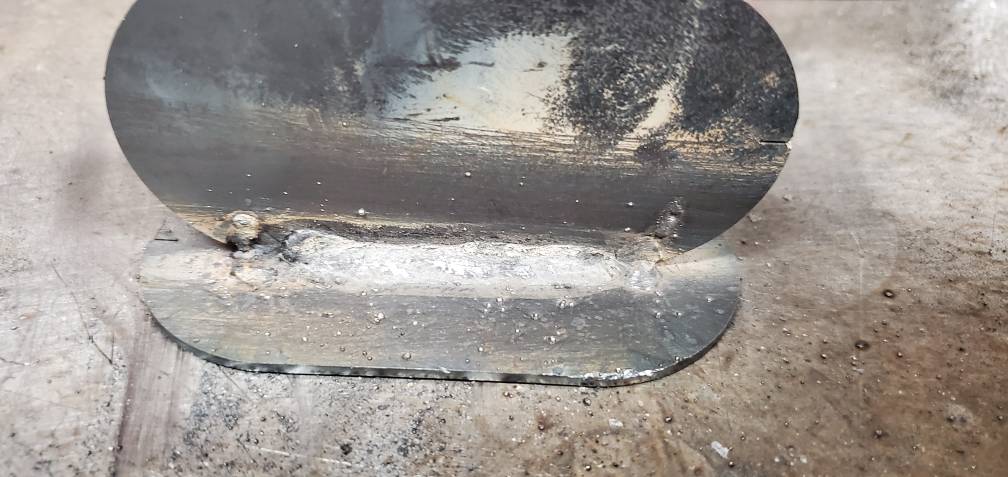

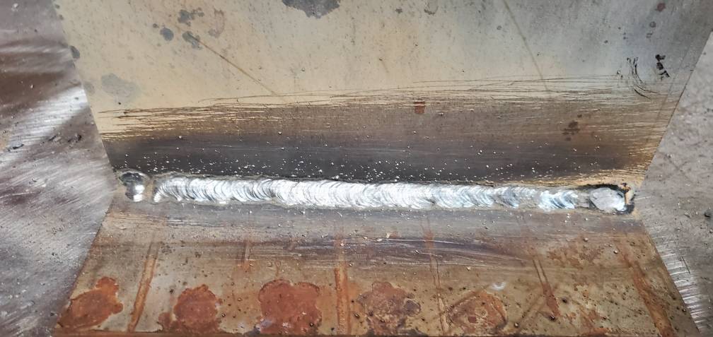

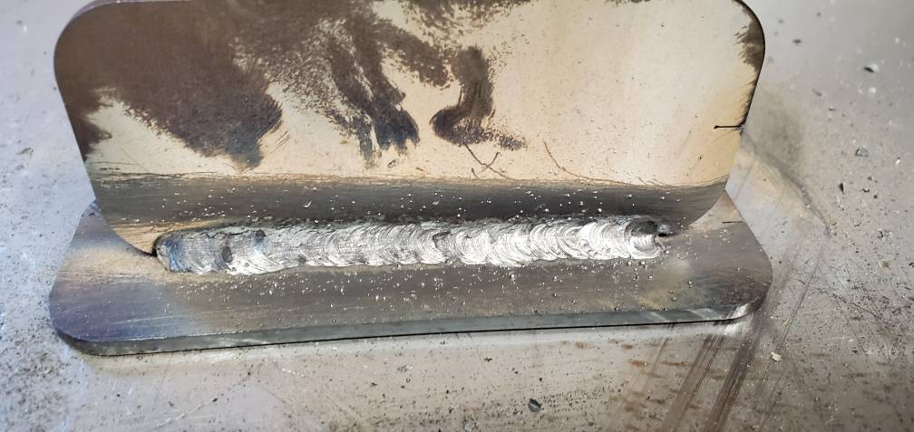

I brought home some scrap from work and started to practice with it. Full disclosure, I've never welded in my life (I'm the quality and safety coordinator at work).
For never Welding before, I'm happy with the results. Obviously I still need to practice more. I was even able to finally get my front differential drain plug off. The plug was trashed (rounded) so I bought a 10mm Allen socket and welded it in place and was easily able to get the drain plug off. The fluid has never been changed (224k miles) so it was definitely due.
I also have a small hole in the frame (golf ball sized) that I need to patch.
The scrap pieces I practiced on were 1/8" to 3/16". It will definitely do up to 1/4" in a single pass. I also had some thinner stuff (14ga) but didn't get any pictures of it.

your welds are nice and clean

Looks good. Practice makes perfect with welding, or at least IMHO.

Welds look very good.. As other stated I never weld above 1/8 plate with it.
