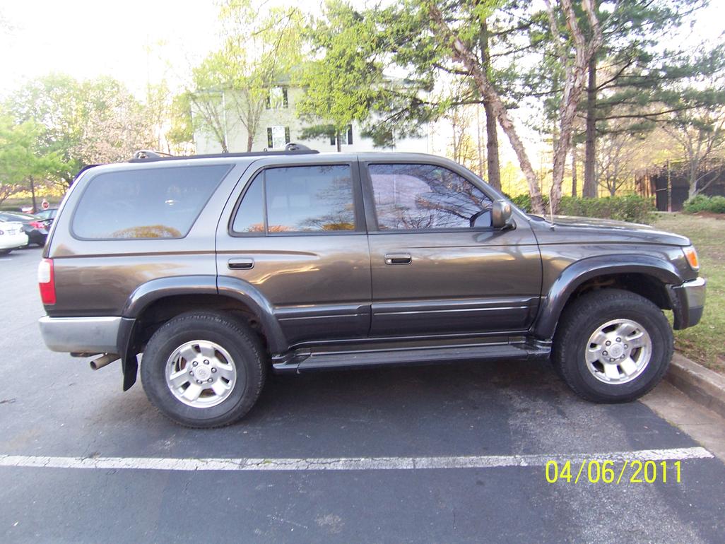

Bought April 1st, my 1998 4x4 LTD, Locker
mastee
Bought it last week, and so far I really like it.
My plan is to keep it as my camping/hiking vehicle.
Does needs some TLC, this is what I have bought so far:
NKG plugs & wires
K&N Air filter
K&N Oil filter n Mobile1 Full Synthetic
Tranny Cooler as advised here (D&E), no milk shake yet, but I just might get a new OEM radiator too
Timing Belt kit from Amazon (it has water pump, thermostat, pullies n other 3 belts too)
Need to clean Throttle body/MAF
Also will do the following.
Coolant Flush
Tranny Drain & Fill
Diff drain & fill
Power Steering fluid flush
Also looking for OEM rotors & pads
What did I miss?

That has to be my favorite color. I really wish they had made them for the 99-00's. It would have been my dream 4runner. Unfortunately I have noticed they oxidize really easy if not taken care of. Looks good though.
Thanks guys, I really like the color, for some reason ATL has an abundance of Green ones.
^So what plugs are recommended for these trucks, I still have not opened mine up, btw got a killer deal with the "BIG35" coupon code on advance auto site ($35 of $85, I think it is still valid?
Nice find, I love that color too.
For plugs, you just need to make sure to get dual electrode plugs. These engines are "wasted spark", so they spark 2x as much as a normal engine will, which will wear out a single electrode plug super fast. NGK makes good dual electrode plugs. Search here and you will find mention of the part number.
You have a pretty good list. Remember to do to fluid in both diffs and the transfer case (same oil in all 3). You could seafoam the engine, always a good idea.

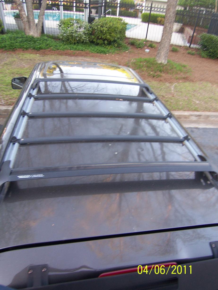

It looks like your back end is sagging a bit. Was it loaded down, or are your rear coils shot?
take your rack off and paint it, shame your not closer Id say come get mine lol..
Nice truck! Tho ive heard that the Ngk plugs arent the best for these...
Who said that? All 3G V6's had 3 NGK's and 3 Denso's from the factory and they are OEM spec, although Toyota sells just the Densos. I've been using NGK's for 100K (since 30K change) and they are fine. Bosch are the plugs that cause problems.
congrats... where does everyone keep finding that color?!?! Jealous
Yup, definitely the best color they came in.
And Im jealous of how good the paint on that hood still is. Most Anthracites I see have faded hoods, and my hood looks horrible...
