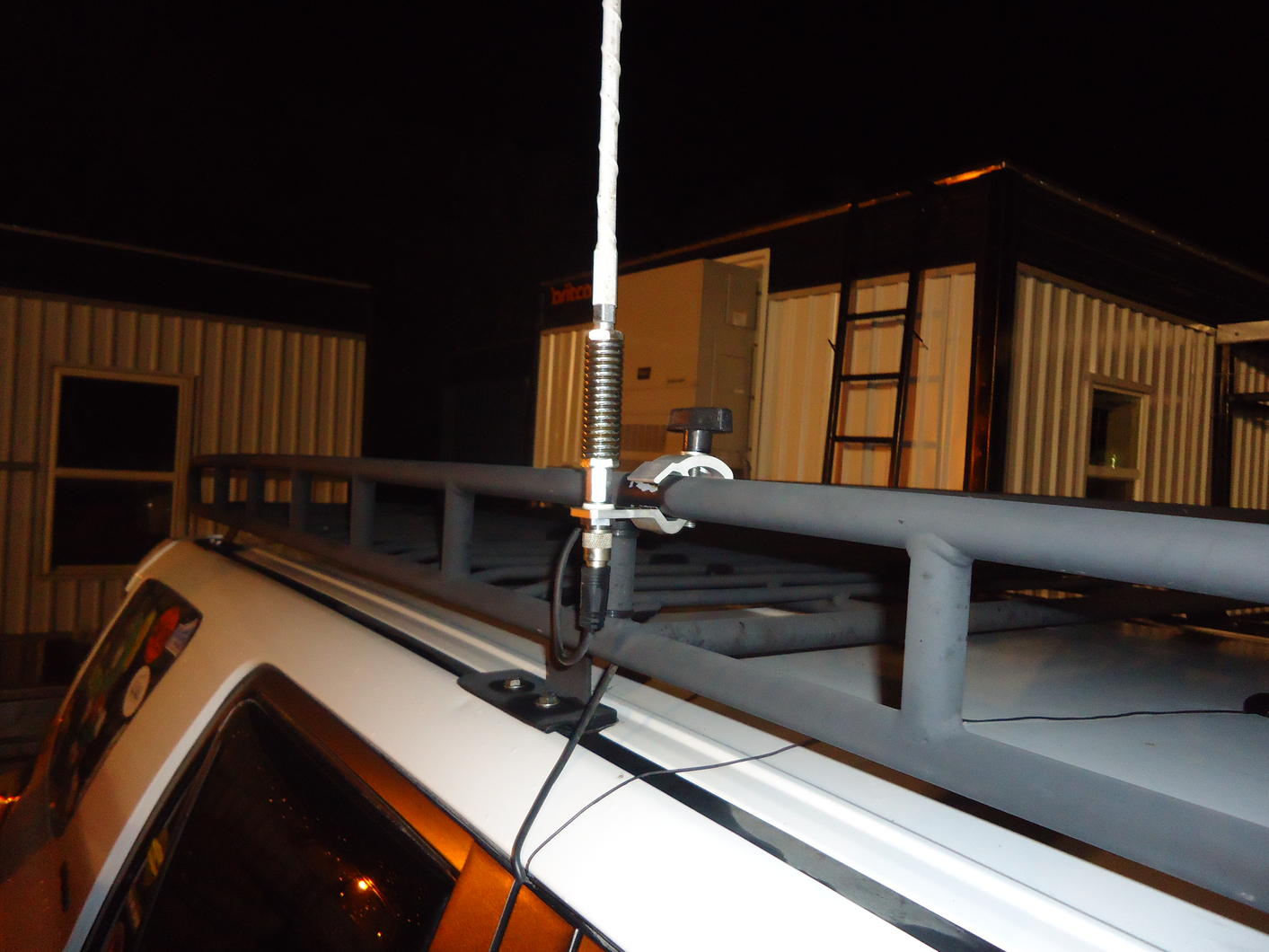

It seems to me some people have dropped the wiring down through the mounting plates (drilling in a plate is required) and I know some have routed it down through the rear hatch. I took a shortcut with my cb antenna coax and ran it into the gap between the front and rear doors then under the seat. My el cheapo XM coax is run the same way. Not as pretty or finished looking, but it has been fine for over 2 years now.
I noticed you still have the old style feet for your rack in that picture. Have you requested a replacement set yet?
No. Mine was bought used in 2014. Baja Rack's replacement deal was first owner and I believe on racks made later. I'm not planning on a RTT anyway, and that's where the weight issue comes into play.
