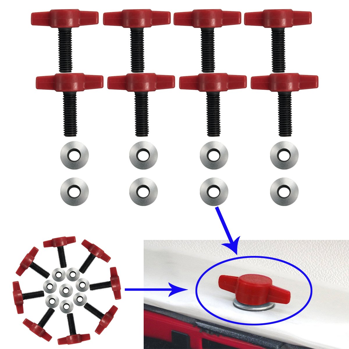

Also, was thinking about using thumb screw fasteners like these. However, haven't thought of a good way to put in a bunch of recessed threads without custom welding an anchor plate.

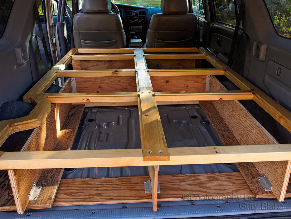

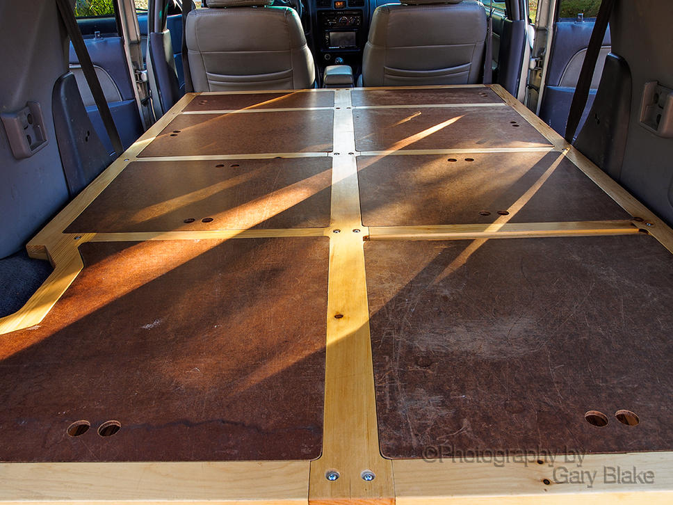

I personally don't know why you would want to attach anything to the top of a sleeping platform. (Attaching a couple of pictures of my set up). Only the actual platform structure is attached by bolts to existing holes in the floor. Anything heavy or that I don't want to move around gets stored in one of the 8 compartments/bins below the platform. There are 8 lift up lids for access and also access from the rear side door and tailgate so I have no problem getting to anything I need.
On top of the platform is a sleeping bag/pillow/air cushion, clothes and dry food. A 12 volt cooler is the only solid item on the top passenger side and it sits on a foam pad which pretty much sticks it to the top of the platform surface.
Gary
