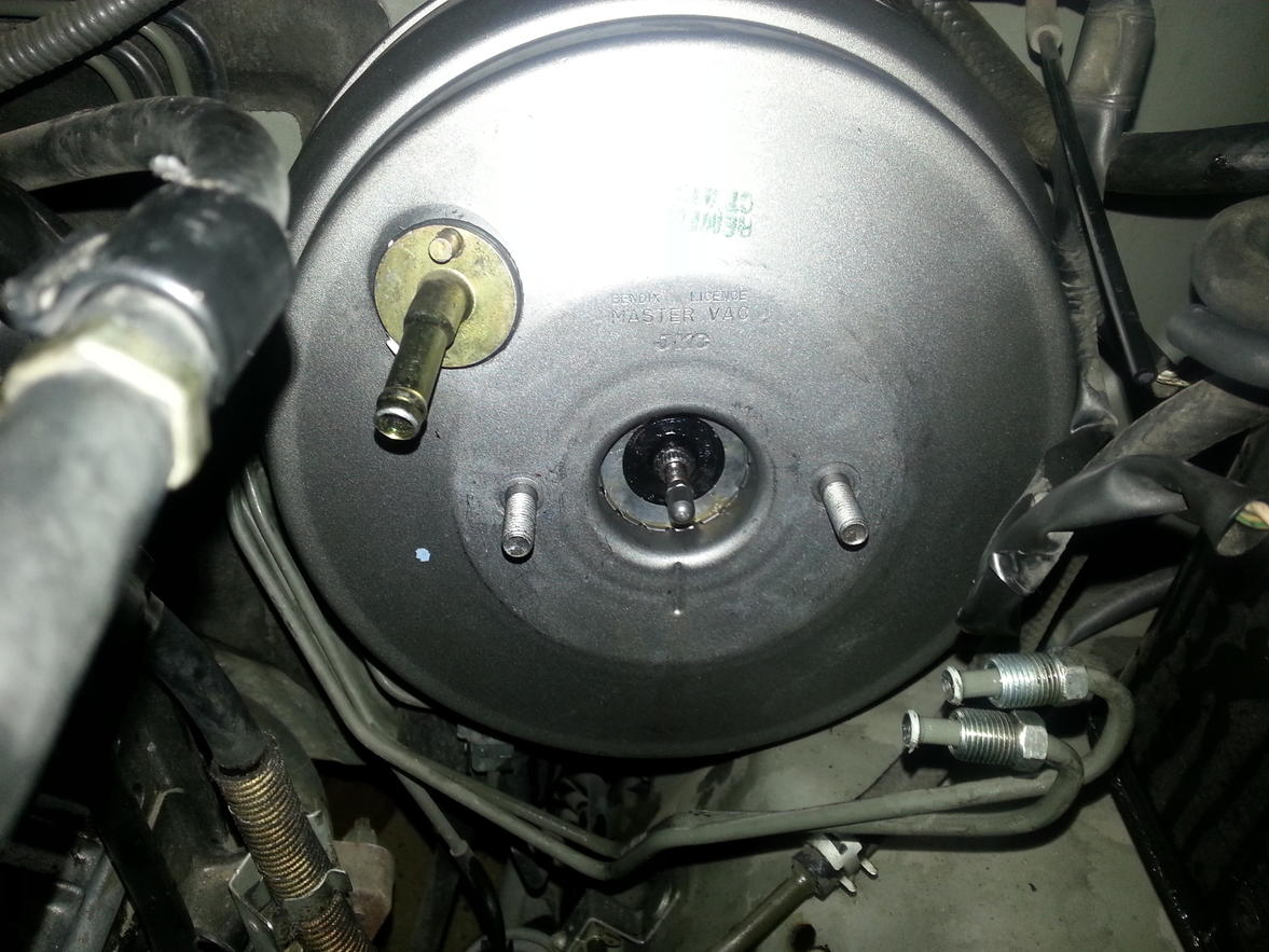

Installing my new booster last night (picture attached). Not a problem on the install but the booster rod was not set properly and is too far out. This should be set to zero clearance. I am using the old one to figure out how to adjust before i ding up the new booster and am not sure how i can adjust inward. Someone told me today just to use a 7mm wrench...push in while screwing inward and it will hit a stop point and allow me to screw it inward. Does anyone have any experience with this. Couple others have said...never have had to adjust them...but this one needs adjustment.

Basically , The rod should just touch the master cylinder.
Use some pliers and wrench. If it doesn't adjust far enough, return and get another one.
i am going to return it. Although I was told that someone must push the brake pedal while you are trying to adjust it. i was able to find a TOYO Booster with only 94k on it for $100. this included the master cylinder too. A lot less than $380.
