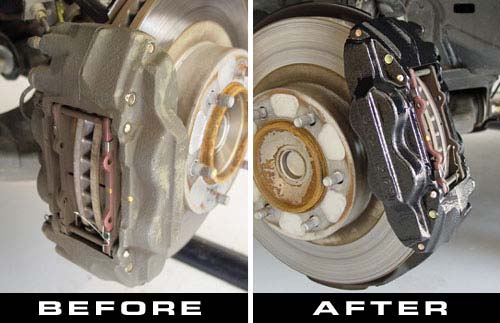

I had the same delima a while back and ended up going with the black and they turned out really nice. They look much better than the stock greyish color. Here is a before and after shot.

Wow, that does look nice! Do you have any pics from the side that show the calipers with the wheels on? The black is definately awesome. I bet it would look great with my black beauty:D

A good tip I got was to clean the calipers with brake cleaner, and to use aluminum foil to cover everything you don't want painted. It works well because you can wrap it around stuff.

A nice metallic black. btw.. how hard is to to take off the calipers on the 4run?
I actually clean and painted mine while they were on it. I just took my time to get everything covered with aluminum foil and to mask off screw heads and such. Also make sure you cover you truck.

good stuff! So you just used caliper paint? I'm guessing brush on stuff but don't they come in a spray can? If you could do a short write up of the stuff you used and methods.. that would surely help a couple of us on here.
(any pics of your wheel, truck, calipers? just to get an idea of the big picture.)

There are some links a couple of posts up that have some pics in them.
Here is a trhead from yotatech that gives some tips.
http://www.yotatech.com/~corey/tech/butnut_painting/butnut_painting.htm
Used the VHT Caliper and Drum Spray paint and it worked out really nice. Just take your time and do a couple of light coats instead of trying to get one heavy coat on it.

so you took little pieces of tin foil and covered the little screws? yikes. thanks for the link.

Actually I put plain masking tape on the screw/bolt heads and used an exacto knife to trim around them. Once the paint was dry, I just pealed it off. Once you take a wheel off and size it up, it is really easy. If you can, do this in a garage where the wind won't swirl the overspray around and get it on your T4R body.......Then post some pics when you get finished.:D
