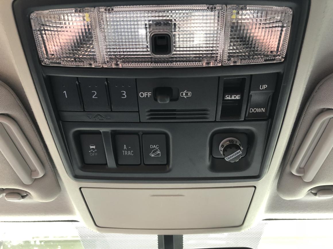

I can verify Redarc works with a 2016 SR5. Clean install in the overhead console.
That looks nice, but why go all the way to the overhead, when there are so many blank switch plates to the left of the steering wheel? (and at least one to the right of the steering wheel). I assume you ran the cable down the drivers A-Piller?
