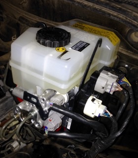

It looks like brake fluid leaking on the frame by driver side front tire. Is it a Booster issue or brake line. Any insight is appreciated. :redbrick:
If you don't know where it is coming from then any response is a shot in the dark. get some degreaser and wash the area down. After drying take it for a short drive then inspect and get back to us.
New Brake Booster going in today. $$$$ thank goodness for Employee Discount and having a Buddy that is a Toyota Tech. $2,600 list new for the Booster. Damn glad I didn't have to pay that much.

Glad you are getting some discount, those things are ridiculously expensive, even on Toyota Parts - Shop OEM Toyota Parts Online at Village Toyota its still over $1500 last I checked.
By the way did you find out why and where it was leaking from?

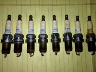

All New. The Old 1 was leaking on the side behind the Black Box. I have it and will look at it more. He did my Spark Plugs (had OEM Denso's waiting a while)which Were Original Plugs all NGK at 127k. Cleaned Throttle Body, Changed Cabin Air Filter, Flushed my Power Steering Fluid. Checked all My Diff Fluids which were done Not Long Ago, Antifreeze, replaced bulb behind clock, Clip on Hood release. Getting ready for Cross Country Drive to Ga from Az.
