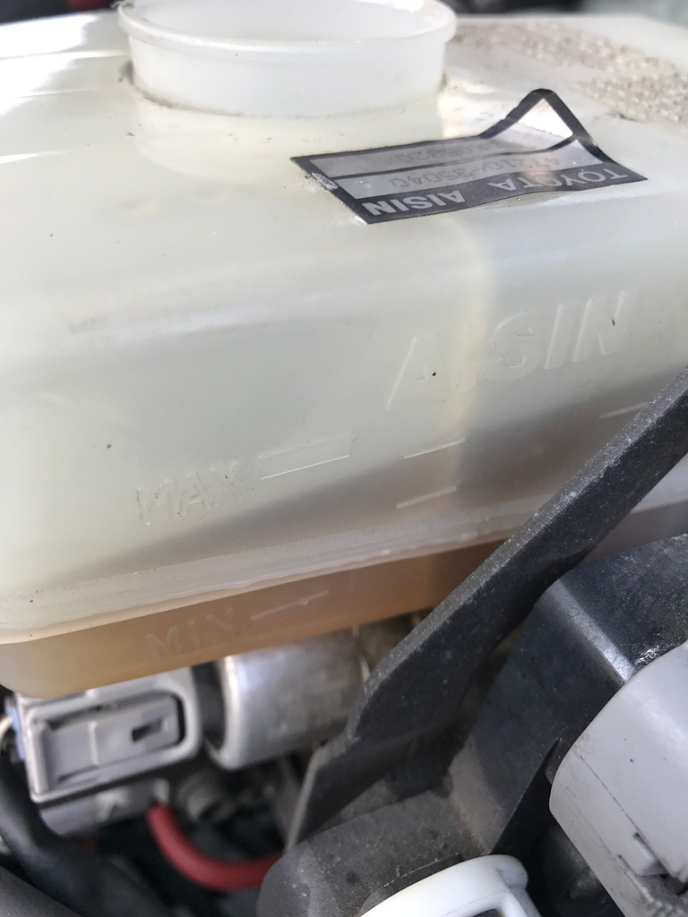

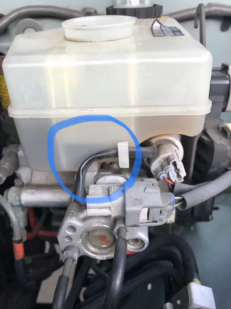

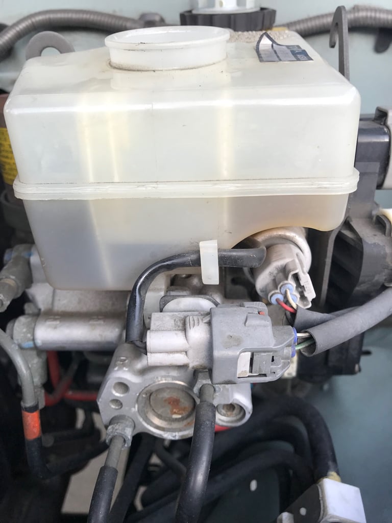

While checking for a humming noise coming from God knows where..I noticed that the fluid seems/looks low in the center section of the reservoir..but it is showing it is topped off.. does this look right??

I actually checked all of my fluid levels this weekend (on level ground) and my brake fluid level is at right where yours is (I have the same complicated brake master cylinder).
Don't quote me on this, but I think that empty space that you see is a sectioned off cavity in the reservoir. Presumably it's there to help keep the fluid level from sloshing around when taking turns?
Also, the fluid reservoir generally doesn't fail. It's the master cylinder that typically fails.

The brake fluid reservoir must have same volumes/leve on all pockets (or cavities what ever you call it). If the level is down on one, then check all 4 wheels to find any signs of a leak. For the rear, you'll have to pull the brake drums off to inspect the wheel cylinder.
