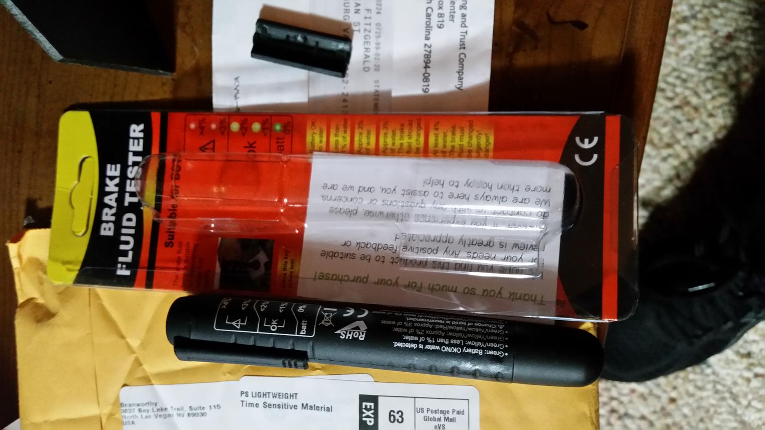

Here it is. Amazon had a sale. There's also some Utube videos on this thing.

We used to use them a lot at the subaru dealership I worked at. Brother in law also uses then at Honda as a service writer to help sell brake flushes. Just stick it in a brand new can of fluid every so often to be sure it's accurate.
We use the battery-operated moisture testers all the time at the race track during tech inspection. Anything more than 1% is a fail.

I tried a test with straight fluid and another with a fluid and water mix. Seems to work fine. I've decided that I'm a fan if this little gadget. Not a bad little purchase if ya can get it shipped free like I did.
I thought brake fluid doesn't circulate.
so if you have moisture in the lines, near the calipers especially you won't see it.
I thought that was the down fall with the test?
I know a few guys in the Porsche club that use them and they say they work fine.
