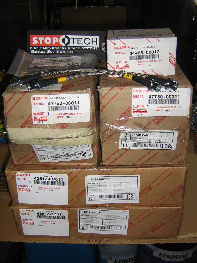

Stop Tech SS cheapest price is on E-Bay. Maybe an inch longer than stock but you only need longer for the rear when lifted.
