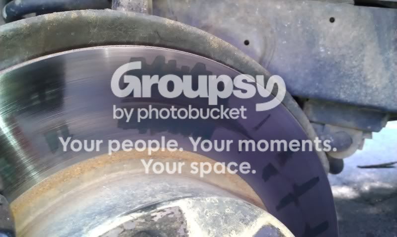

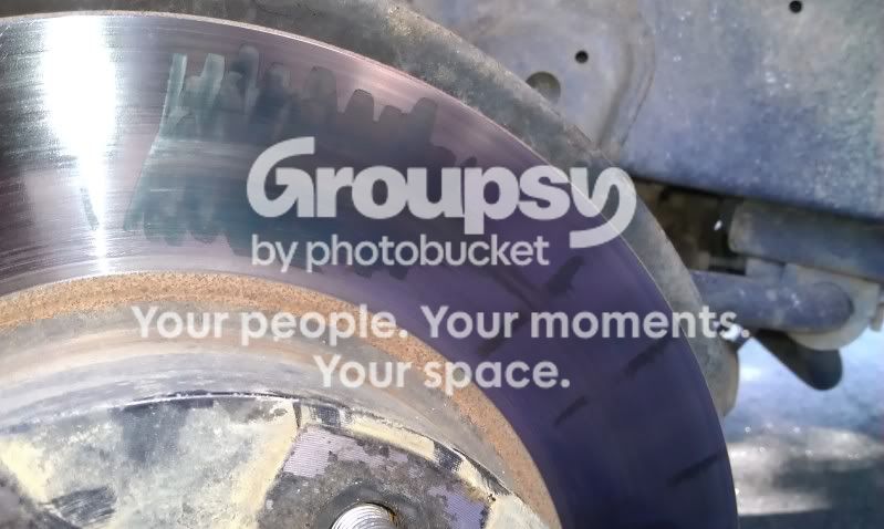

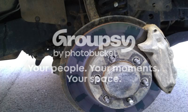

Well i took your advice NOT ME OR SOMEBODY and tried that line test on the rotors.
Driver

all i had was a blue highligher, but you can still see the "tail" which shows it is rubbing.
Yes I see the pics but I can't tell much, it looks like it is pretty evenly distibuted.
Can you tell more in person?
I would expect to see places where the marks were rubbed off in an area and then it would be untouched or at least lighter in another if the rotors were in fact warped.
You have to realize this is a very crude shade tree mechanic way of checking, and the proper way would be to use solidly mounted a dail indicator or something that could closely measure the run out /deflection/warpage or whatever you like to refer to it as.
anyways no harm done in trying.
Best wishes from a HOKIE FAN
Yeah i know what you mean, It is definitely easier to turn in some places, and some of the lines in those areas were untouched. I just made the areas where it rubbed bigger to show how it was rubbing. I appreciate the help man. I'll be replacing the rotors over the 4th of July weekend, so hopefully everything works out.
