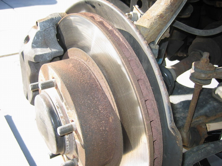

Looked at brakes today ...
I decided to start with just the fronts to see how that would effect the way it drives. I looked at the discs and they don't look like they need to be replaced. Pads have about 1/4" left and don't squeal yet so I just did a bleed job on all 4 wheels. I'll be taking it out later to see what effect it has (currently, it requires a deep push on the pedal to get any braking).
Pic of rotor below ..... doesn't look bad to me.

Measure the thickness of those old rotors, this should give you an idea of how much life was left in them. The service manual states:
Std Thickness 22.0mm
Min thickness 20mm (when you should replace)
The pad lining min thickness is 1mm, so you still have plenty of life in them (std thickness is 11.5mm).
If the brakes start pulsating after you've replaced the pads, they'll need to be turned. I usually just scuff them with some emery cloth unless they are grooved, or have a ridge at the top.
Measuring thickness with a micrometer is a good idea too.
edit: as far as pad wear, a good rule of thumb is that when the pad material reaches the thickness of the backing plate (or less) it's time to replace them.
