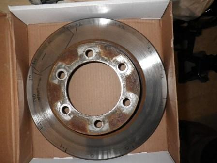

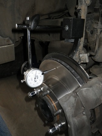

so i had some time and some of my equipment handy so i decided to do some measurements on the rotors. Last year i did a hard brake to avoid a deer and came to a dead stop from 100km- zero, and i knew i imprinted the rotors as i have been having vibration issues when braking above 60km/h.
So in summary, This is what i found

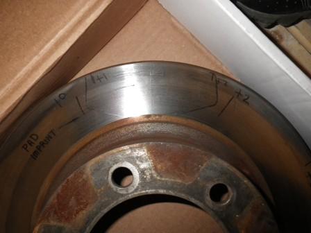

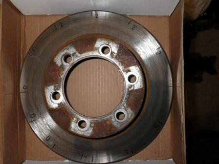

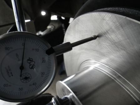

1. I had roughly 0.004" of variation for the old imprinted rotor
2. 0.001" of variation for the new rotors.
You can see from the shot below where the brake pad imprinted a pattern on the rotor.
I was surprised that such a small variation would cause that much vibration. The rotor thickness was almost the same as the new ones. See pics below.

Very interesting. I would have thought the difference would have been greater than that. So, is the vibration gone now?
Well I still have to do a proper bedding in , but no vibration when i took a spin yesterday. I was really expecting alot more variation. I don't have a micrometer, so I didnt take thickness measurements within the pad imprint area, I suspect it would have been a lot less at that spot.
