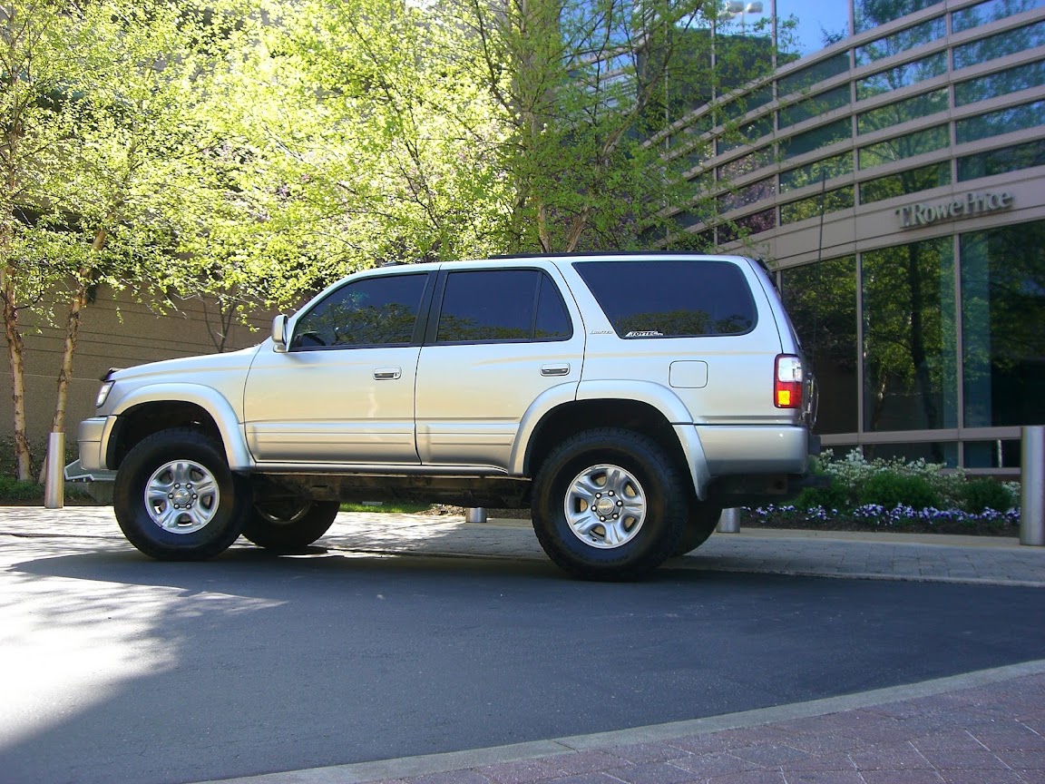

Bump. They've been installed, pictures up after I get her washed today. Night and day difference. My 4Runner now stops better than my RDX, and pedal feel is up 10 fold. Slotted rotors are a bit noisy at full "lock", but man do they bite hard. Also, no more rusty rear drums. Truck looks like new. Sa-weet!:cheers:

Hard to see the slots but they're there. Definitely worth every penny. I suggest getting new hardware when replacing the front brakes yourself, like the retaining clip and springs. The rear drums were completely stock and had never been messed with (nor had the shoes... well past their lifespan at 148,000 miles) so yes, it was a HUGE improvement.
