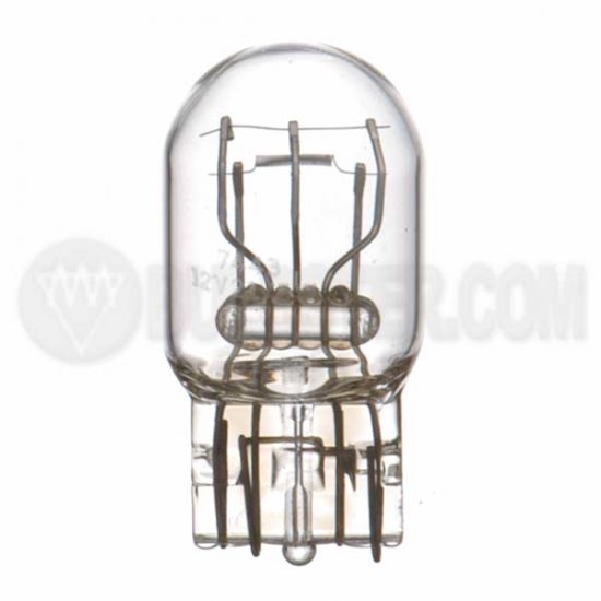

H henqc New member Mar 3, 2011 #1 Hello everyone, I have a question about my 97 4runner. So my tail light does not light up, but my brake lights still work. The manual says they are the same bulb. How can this be?? Any help will be greatly appreciated. Thanks in advance
cfranck1 New member Mar 3, 2011 #2 They are a dual filament bulb. One for the brake light up and one for the tail light up. The bulb number should be a 7443 Heres a picture of it. Attachments 7443bulb.jpg 26.2 KB · Views: 10,644
